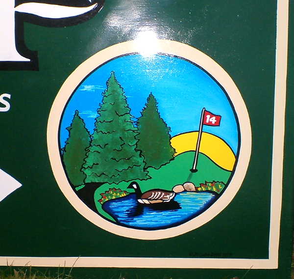

    😳 Gee thanx folks.
    Lynn, it’s all paint, I just used a darker tone to make a faux shadow.
    I think I put about 8 total hours into it over 2 days.
    Andy, you’re right, you do have to wait for paint to dry before you can proceed to other parts.
    The GOLF and the arrow were painted using a mask….I roller-blended the golf part.
    The rest was painted using a pounce pattern.
    Here is the pictorial. (their existing but beefed up) I blended the trees with a sea sponge.

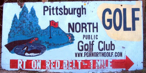

    29 November 2005 at 03:26
    Nope, Steve, I only changed it 3 times….
    Here is the original BTW….not my work
    (I think Lambie painted this one)
    (it’s 25 years old)
  • Leigh
    29 November 2005 at 03:50
    oh Jeeze what a difference between the two huh
    Great work Jill!
    Did you have any trouble with the 1shot in this weather (assuming it’s humid near you as well)…how much longer does it take to dry?
    How many base coats did you use…..looks like really good coverage

    Turned out great Jill! I reallly like that natural shadow, it looks sooo real.
    Jill, that artist is still in there!
    I’ve always stared in awe at the way you can look at a picture and just paint it. I mean I’d have to sketch it out do some erasing and tweaking then paint it in. You have a great talent for this and always love to see you do it.
