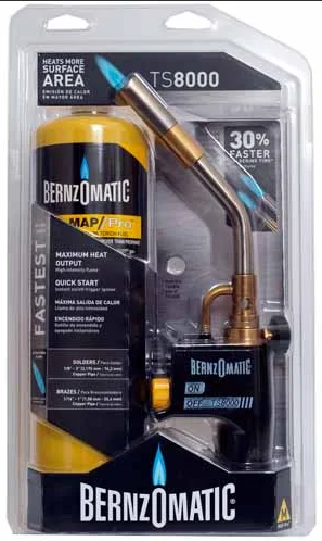

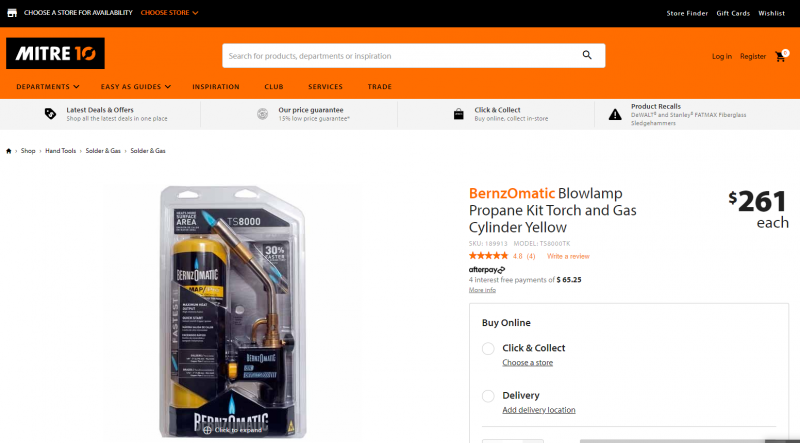

  • Simon Worrall
    July 6, 2023 at 10:19 pm
    Thanks, Gordon.
    I found this one which is a plumber’s torch. It does the trick exactly as I wanted, $261nzd.
    It was very well-reviewed on youtube.
    I am doing a mural using Arlon 6700 high tack cast vinyl.
    I tried a test piece, it is perfect for getting enough heat to press the vinyl into the concrete very quickly.
    Obviously, the vinyl catches fire if you leave it on a second too long, so…. 🙂
    Website: mitre10.co.nz
    https://www.youtube.com/watch?v=VjRWRsLobpM
  • Mark Johnston
    July 10, 2023 at 1:13 pm
    Obviously the vinyl catches fire if you leave it on a second too long
    Exactly why I never got around to trying one of those blow torches.
    I have always thought they looked very awkward to hold. 🤨

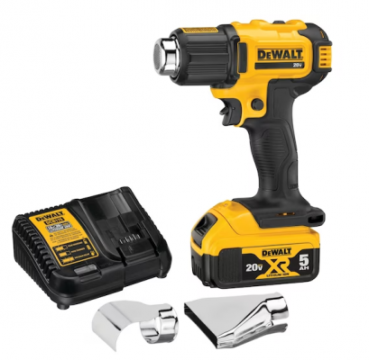

    July 17, 2023 at 1:31 am
    I dislike these torches and as much as I know they are widely used worldwide by other wrappers, I still prefer not to use one.
    That said, I may contradict myself someday soon because I am tempted to buy one for remote vinyl installs and/or removals.
    I have an inverter in my van, which I can run heat guns from, but I have still been caught out in places I can’t even get the van close to.
    I also have a cordless heat gun by Dewalt but the reality is, you will get 15 mins of heat and although the heat is not bad, the “blow power” is no stronger than a yawn!

  • Simon Worrall
    July 24, 2023 at 3:54 am
    Definitely not for the faint hearted! But its instant heat, anywhere, without a cord.
    If you hold it at least a foot away from the work its manageable.
    The shape is rather cumbersome to put down safely, it can easily tip over and bend the tip or burn something. So thats a worry.
    In use its very light and balanced, no faults there.
    I have added it to my kitbox and I use it out on jobs where its a pain to drag a 30m cable over a dirty workshop floor.
    Having bought the thing I have found it really useful for various jobs round the workshop including my own hobby, building radio control planes.
    Yup. Nerd.☺
    A good purchase.
  • David Rogers
    August 24, 2023 at 11:23 pm
    Looks interesting.
    https://hilltop-products.co.uk/tools-cutters-machinery/heat-guns/cordless-gas-heat-guns/e4500-gas-powered-hot-air-tool-kit.html
    Always have my gas gun handy but more for quick blasts or remote jobs.
    Occasionally use them at the shop for speed.
    Also have a makita 18v gun, but as Rob said…hot yawn. No point in using outdoors!
