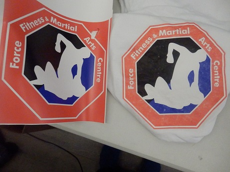

    hope someone can help me out,
    got a bn-20 installed last week and have been printing t shirt vinyls,
    all looks great until one customer said about some slight fading after one wash.
    i ran some test and even bought a few diferent brands. i have attached a photo of a t shirt after one wash, garment inside out, temperature etc below what it says is the limits.
    someone please help 🙁 i have a load of work similar to do but i have no confidence at the minute and totally scared to sell anymore incase it all comes back.

    David
    it has always been an issue which is why it never really took off, thats not to say there aren’t materials out there that work. Siser does a heat applied clear that helps to protect the print the other is to make sure the profiles and print temp is correct just because print looks good doesn’t mean its bitten in. Try speaking with Grafityp they do Siser products
    Kev
  • David Mitchell
    February 14, 2016 at 6:14 pm
    thanks kevin, i have been looking at the laminate that siser do.
    one problem is, i was buying transfers in and been supplying that same logo for a year with no problem, until i print my own and they are terrible after a wash 🙁 at my wits end

    Did you leave to gas off for 24 hrs?
    We too have had similar problems with the mimaki, leaving longer before pressing onto a garment helps
  • David Mitchell
    February 14, 2016 at 6:29 pm
    yes denise was also left for 24 hours after pressing onto the shirt too.
    i sent samples back to where i purchased it from, but as its the weekend they are closed.
    i cant find anywhere to check the temperature kevin spoke of ?
  • David Mitchell
    February 14, 2016 at 7:08 pm
    printer heater is fixed at 35 degrees on the bn 20 since found that out, which matches vinyl spec.
  • Kevin Flowers
    February 14, 2016 at 9:55 pm
    Simon
    you need to leave prints before pressing as the heat from the press will cure the ink before gasses have have escaped, not saying it will cure problem but worth trying. Was your original supplier using a Roland, not used a BN20 so can only go on my previous machines. Speak with Roland as well they have a wealth of knowledge.
    Kev

    February 15, 2016 at 7:09 am
    thank you both for your input, much appreciated, i will keep the post updated
  • Dan Osterbery
    February 15, 2016 at 7:16 pm
    Leave 24 hours before pressing, cool wash, and no where near the tumble dryer!! We have found xpres, and the magic touch soldark, are the most hard wearing transfers! Goodluck
  • David Mitchell
    February 16, 2016 at 4:29 pm
    thanks guys, making slight progress, problem really seams o be with the red, other colours holding up not bad
  • David Mitchell
    March 4, 2016 at 1:58 pm
    hey guys thanks for everyones input.
    the outcome,
    i was sold media which is not compatible with "eco sol max 3" inks
    the company gave me a refund on the media i purchased, and to compensate sent me media that appears to be performing well and holding its colour after washing.
