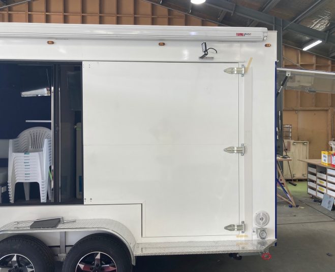

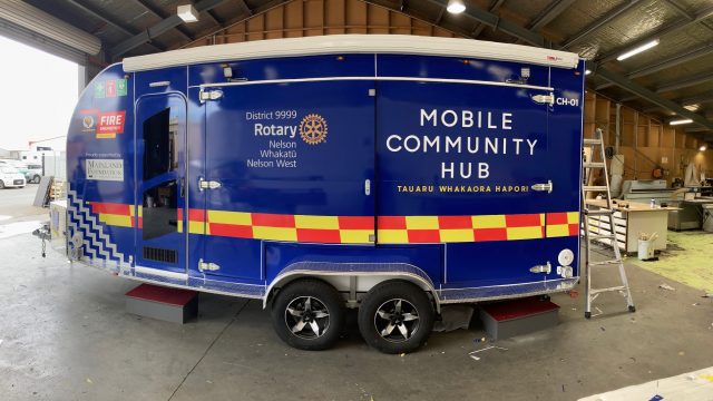

This is the first of eleven control vehicles for the fire department that are being built here in town.

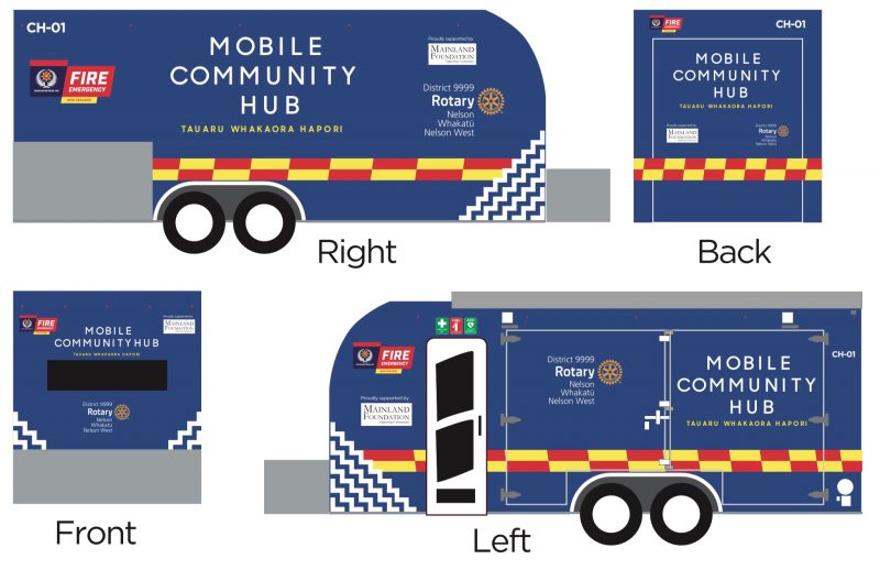

As they build them I will wrap them blue, followed by various reflective logos, chevrons, sponsors etc.

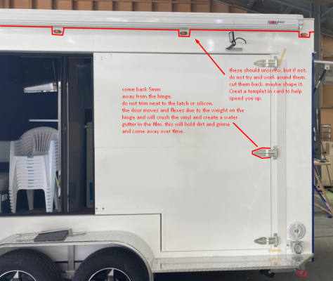

Unfortunately, while the sponsors, fire department, other interested parties and I were playing email tag with designs, placements etc, the builders went ahead and installed all the lights, hinges, fittings, awnings, using glue, silicone, and screws, and they are now impossible to remove, so now I have to wrap around them, cut them out, and still make it look good.
What was a nice earning job on this first one has turned into a bit of a mission. My limited wrapping skills have been stretched to the utmost, and this job has gone from a few days to a couple of weeks.
