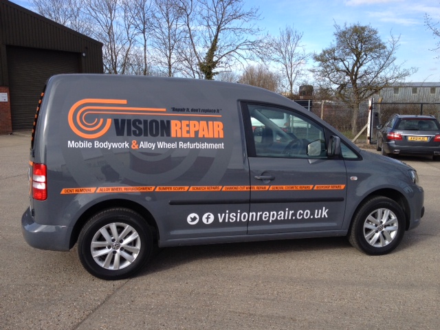

    I’ve been sent a design by a company with swirls on the side of a car with the letters over lapping it. I have heard on this site people talking about window frosted vinyl applied and remember them saying it looked nice. Has anybody done this? Opinions/Pitfalls? And if possible a photo to show the affect.

    Dont think there would be any problems as long as the vinyl is rated for outdoor use. Some of the cast etch is easy to handle, and is thin enough for this use. It will grey out the colour behind, and Ive used the effect on shop windows. The most recent, I cut the logo and inlayed the coloured vinyl and finished off with cut text of the same colour applied to the rear of the frost.

    We did this on a van a couple of months ago. We used a cast matte laminate and the effect is really nice. It makes much more of an impact in the flesh as when it goes by it makes you look again.

    Thanks for all your comments and photos. I thought it would look nice but just wanted to see it before I went ahead. I will post a few photos once I’ve done the job

    Thanks for the Advice, Here’s a couple of photos of the finished job. Roof is done in Matt White with gloss cut letters.
