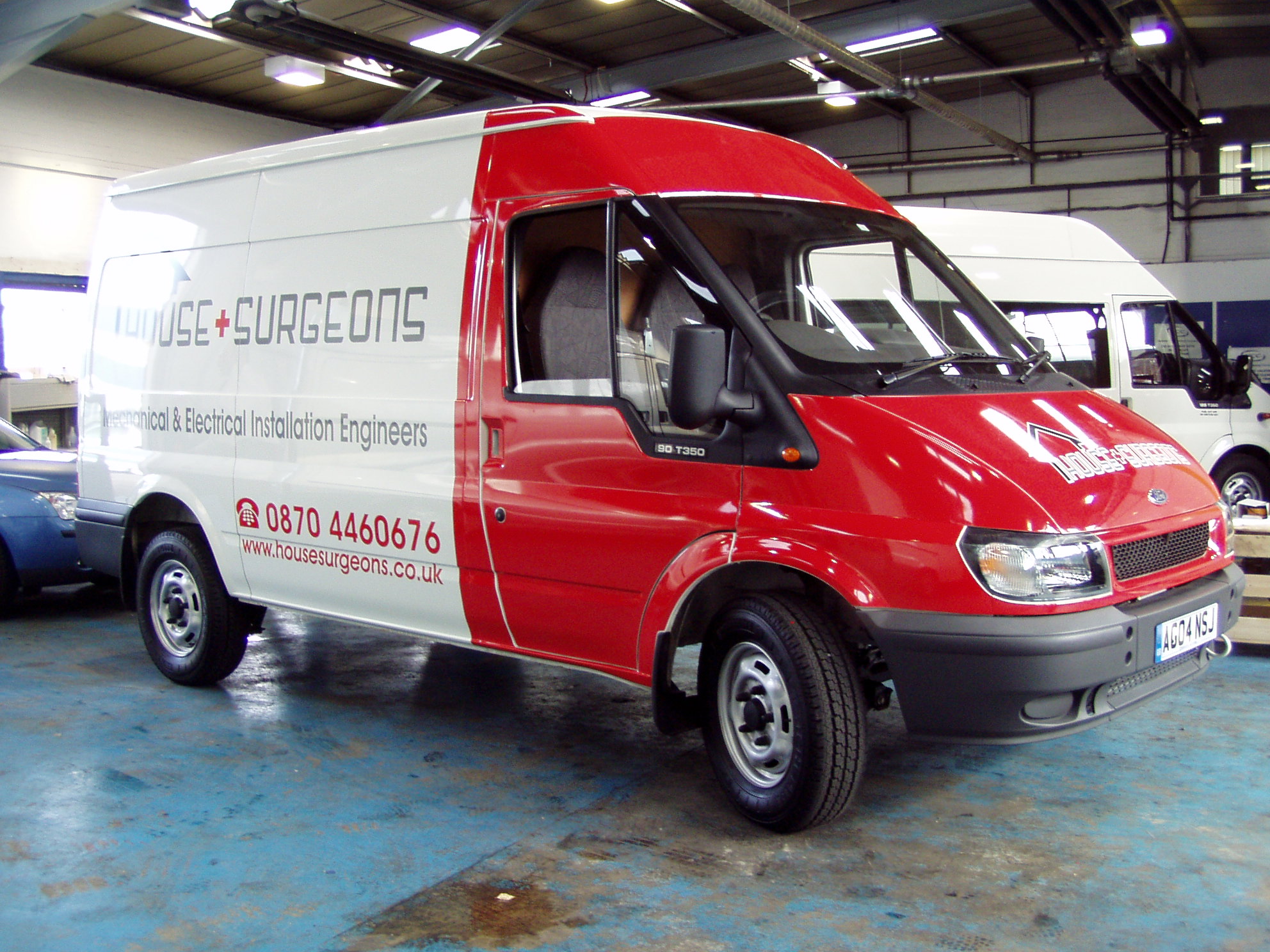

    Do you trim on the vehicle to get the shape around the door windows?

    Yes warren, pretty much stuck round where I wanted the shape then used masking tape to make the line template and cut upto it.

    Yes fitted them by myself, not unlike a workout at the gym using teeth and toes (almost) as another pair of hands juggling heatgun and vinyl which was hexis CG6700 vehicle conform series – taxi wrap…quite forgiving and quite thick.

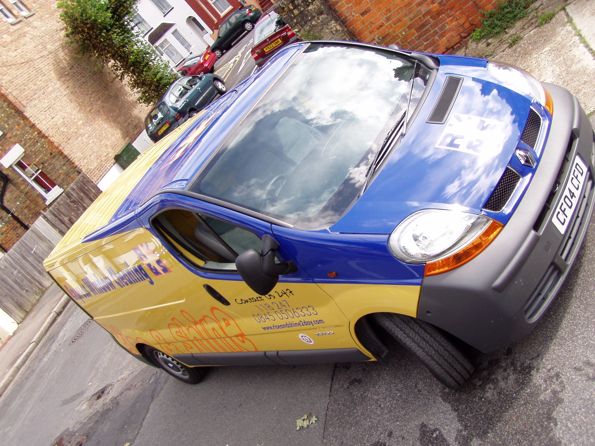

    That Trafic roof must have been tricky. Did that vinyl go in the recesses ok?
  • graham stewart
    October 3, 2007 at 12:22 pm
    Hello Cheryl
    Like what I see,Looks Great , When you cut the vinyl to the contour of the job does it mark the paint work?
    Graham
  • Cheryl Smith
    October 3, 2007 at 12:36 pm
    do you know Graham, thats what the customer always nervously asks me
    and I always say no.
    I was shocked when I got on the roof and found out how darned bumpy it was up there! more work! but yes, had to contour it all in there too.
    (you’d imagine roofs to be all flat but BEWARE not true)
