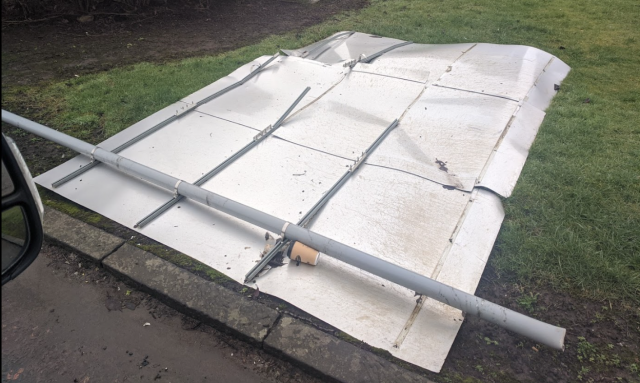

Posted by Robert Lambie on January 25, 2022 at 10:03 pmThis sign was made by a sign company local to me.
as you can see, It has fallen down and this is its current state.
There are a few things that are wrong with how it has been made which ultimately has led the sign to fail and now be on the ground.
The only thing missing from this picture is the second post that held it up. everything else is shown, as is.Does anyone notice flaws in how it has been manufactured?

What looks like the top of the sign, is actually the bottom. the steel posts have snapped off.

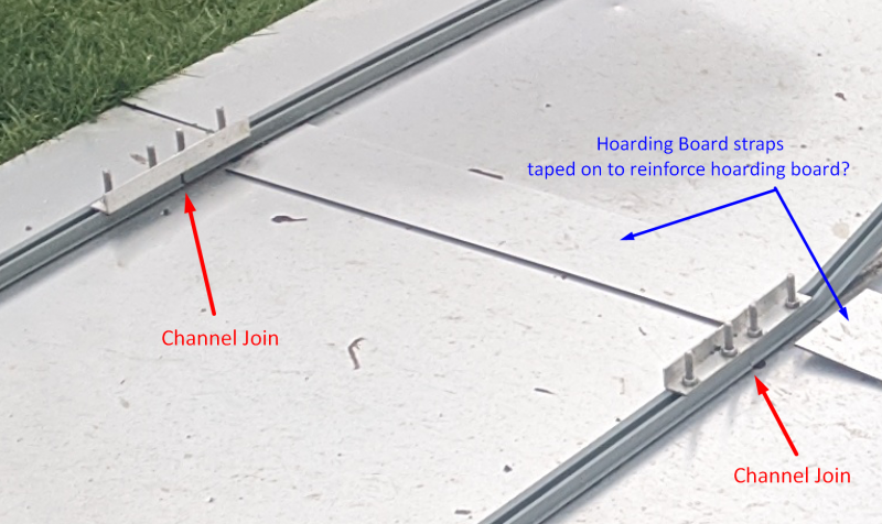

Apart from the flimsy construction, the bridges in the cross members are joined over the panel joints.
But fatally, someone left an upturned cup of HOT coffee over the connection to the support, so given that this is in Scotland, differential expansion from thermal stress. I believe the same problem can happen in Eastborne in the summer with mojitos. Particularly if the straws snap.
There doesn’t appear to be any mechanical fixings, just VHB holding the rail.
The silver/mill reverse, perhaps its a cheap hoarding grade ACM
2 posts, I’d have gone with 3 at least, if not 4.

Looks like the wind load is way too much for just TWO x 89mm ally posts by the looks and just snapped them at the base… seen this happen a few times
but the way it has been made is frightening…

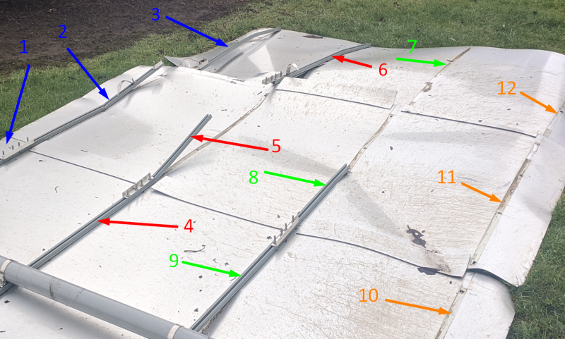

It gets worse when you look closer!
* The Sign is made from Hoarding Board.
* The joining straps are attached by double-sided tape.
* the joining straps are made from Hoarding board.
* Instead of lengths of channel, spanning the full-width of the sign.
They have used 12 individual pieces and tried to join them with those small bits of L-shape aluminium angle. -

The only reason I can see for them making it with 12 pieces of channel is so it would fit in their van. Other than that the mind boggles
For all the value of sign channel they must be crazy to try and scrimp on that. Not worth the risk

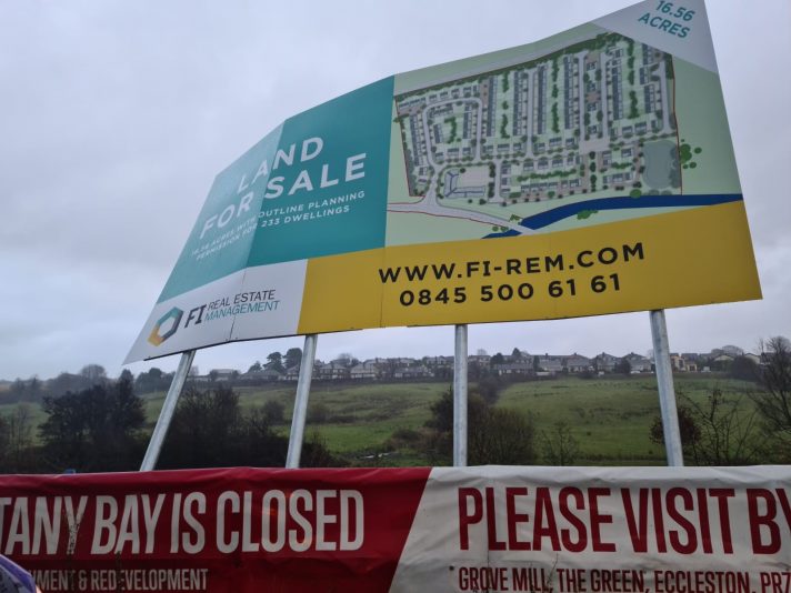

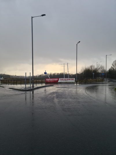

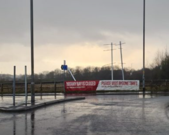

I think we’ve come across 2 more signs they exported to Lancashire. We attended an emergency call out to demolish what was left of them during recent high winds.
See the photos – batch of two signs, one still ‘intact’ and the other missing all the panels and a post. Overall sign face 6m width x 3m height made from 4x portrait 10*5’s, base of panels to the ground 2m’s, overall height then at 5m’s. Each post had 3 or 4 random widths of sign rail on and unconnected to any rail on the adjacent posts/panels. The panels were butt joined and held together with strips of ACM D/S taped in place over the joins with the only mechanical fixings being a couple of self-tappers top and bottom of each strip. Come to think of its possible the sign rails were just taped and had no mechanical fixings – Can’t remember but most likely based on the rest of the construction. They’d used 89mm steel posts and a fair amount of post mix, however the incredibly steep fall angle of the land immediately behind the sign meant there was effectively no bracing to the rear of the signs – any leverage from the front would tip the posts. It was quite stormy when we went out but to be honest if a cow had farted in the next field it would have knocked them down.
Must have been the same company – surely there can’t be two out there working to these high standards!
I’m going to hazard a guess its not a million miles away from the M61 either if its near Bottany Bay🤨
