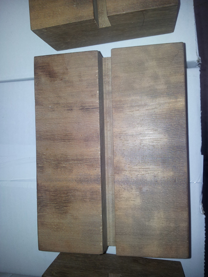

  • Dan Osterbery
    15 May 2012 at 16:00
    Hi Warren,
    our workshop is next to a chippie, and he has just made these for me for 10mm kappafix, works well and also cheap as chips! look quality as well (well i think so!)
    cheers
    Dan

  • Dan Osterbery
    15 May 2012 at 17:37
    Hi warren, you could use correx and strengthen the back with off cuts of 5mm or 10mm foam if you have any? We have done that before for short term stuff? does that make sense, my bits of wood were 12 euros each, so you could make some and loan them to the client?
    cheers
    Dan
