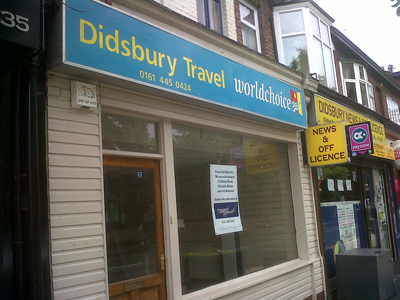

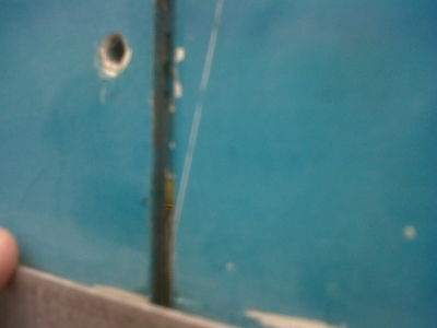

    I’ve attached two pic’s.
    First is showing the join in the sign, and where it’s been riveted previously?
    Another showing the vinyl… looks like Opal acrylic but it’s not

    Oh, I stand corrected- probably what you have there is a sign reused at least once…
    I vote for alu composite as well. Foamex can warp or become brittle and crack- you never know until it is too late 🙂 And the price difference between the two is so little.
