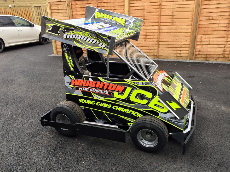

    100% Oracal 6510 Best Stuff Out there.. The 7510 is too thick imho..
    I use the stuff day in day out doing motorsport graphics like the attached image and wouldnt use anything else ever again.

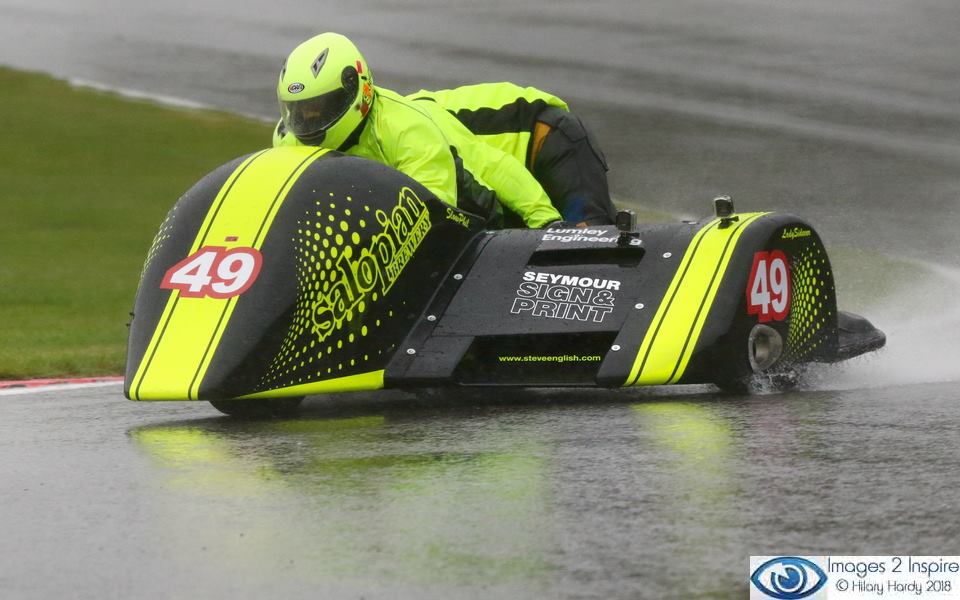

    November 1, 2018 at 2:18 pm
    Got some 7510 from Europoint.
    Here’s the finished article out on track.

    November 3, 2018 at 5:49 pm
    No we’re not 😆 Definitely a sidecar was my previous drivers new outfit. So long as it stays behind us I’ll be even happier 😆

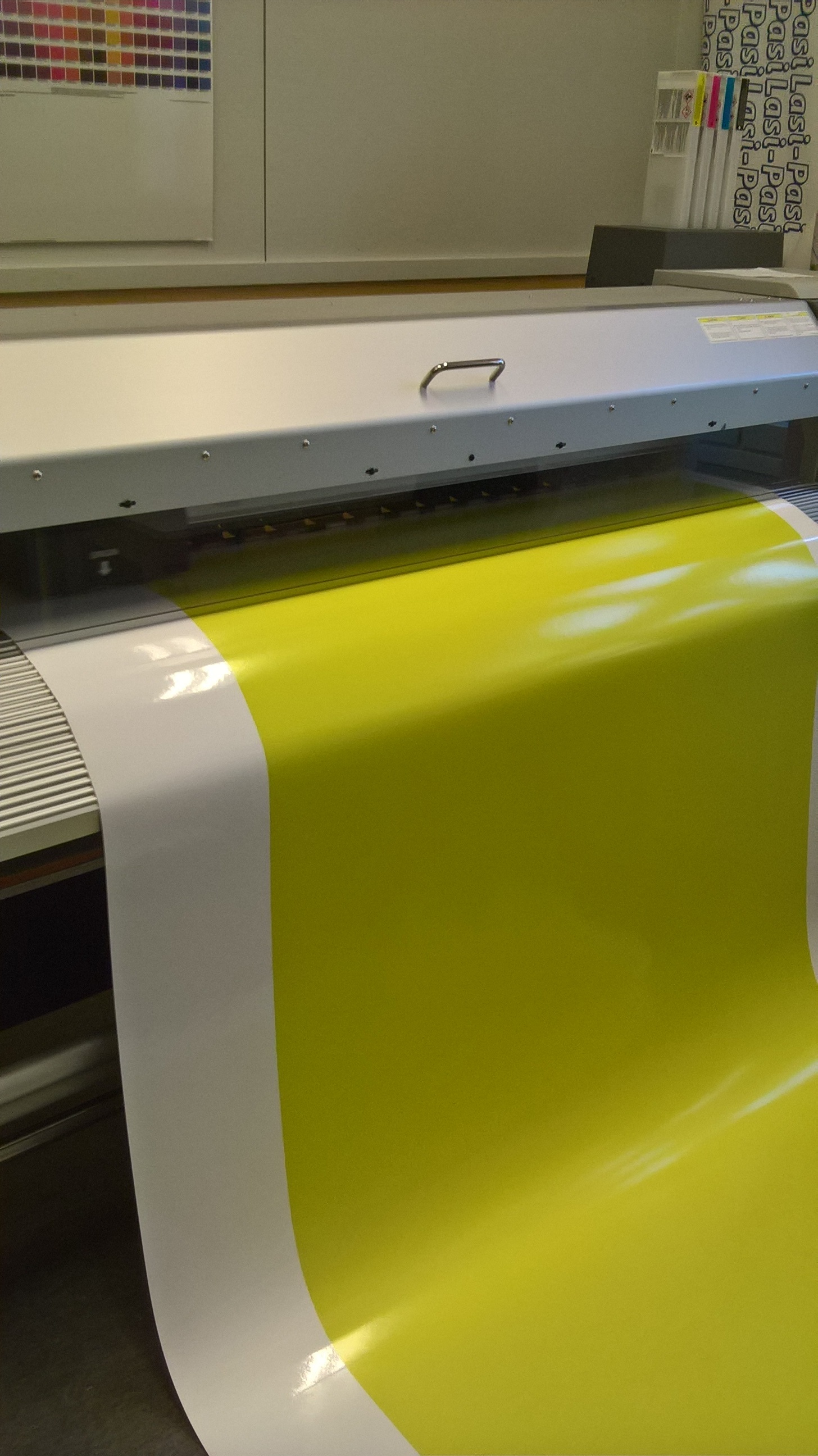

    August 5, 2019 at 10:22 am
    Having gone through the options i decided for durability the best option was to print my own fluorescent yellow.
    Now is it fluorescent, no but it looks as damn close i could get and the customers happy.
    C6 M0 Y100 K0
    Hope this helps others out

  • Martyn Heath
    August 5, 2019 at 12:29 pm
    Looks damn good to me
