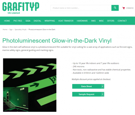

would you be thinking “photoluminescent”.
e.g. glow in the dark?
https://www.grafityp.co.ukWe have a printable version although I can’t remember where we bought it.
You could possibly print on that one and cover it with a non-slip floor laminate -
My only concern with using this stuff on floors is the thickness of it, it could potentially be a hazard in itself. I’d be tempted to use an oversized non slip laminate to effective smooth the edge out.
