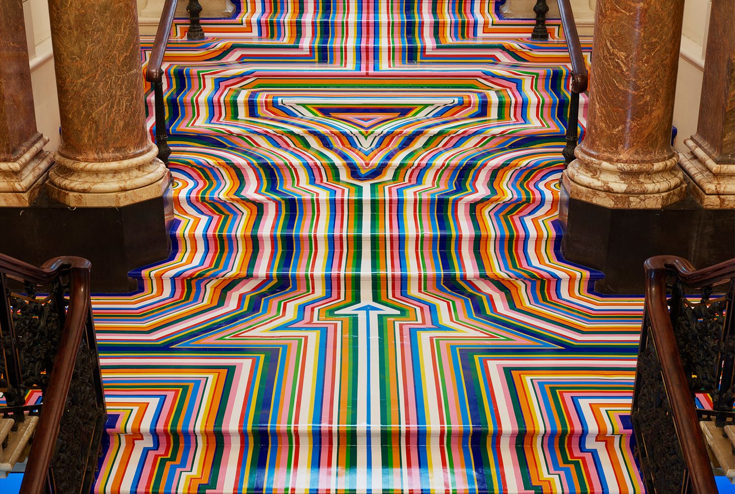

    We have huge floor graphic installations all over the world with huge footfall, and wear and tear is minimal in "our experience". we have done anti-skid laminate floors and regular coloured floors with no laminate. your biggest problem is high heels dragging / scuffing.
    Our floors are up to 700 sq metres, with footfall of around 300,000 people within 1-2 months, so not small areas or low volume, however, i would imagine more in an airport!
    I would say a softer floor causes more wear and tear, i.e. vinyl cushion floor like in a kitchen. this is because it lets anything sharp like a heel dig in and do more damage.
    However, edges of tiles will wear quicker than the recess of the tile or flat areas, due to abrasion and scuffing.
    Use the opportunity to up-sell an ongoing maintenance package for the work. lets say a new vinyl skin every 12-24 months?
    I would imagine this less hassle, and cheaper on the nose of removing tiles and all sorts. it also lets them upgrade/change the design whenever suits.

    Vinyl used varies on the floor its being fitted too, time it has to be down and colours used, sometimes even the adhesive on the vinyl has to be taken into consideration. but on the whole a good quality cast will suffice.
    Time for installation is again down to the room size, amount of installers and how complex the paremetre wall is as thats what dictates the pattern that evolves in the middle. the busier it is the more cutting and direction changing makes a much longer install. we have rooms done with teams of 5-15 people taking 3x 12hr days up to 3 full weeks of installation time.
    The killer is knees, back and neck… think how you would feel if someone told you to just kneel or even sit on a concrete floor for a week for 12 hours a day. not fun! 😆
