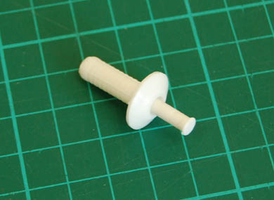

    November 4, 2015 at 10:18 am
    Thanks Gary,
    Ideally I’m after something like this. Do you stock anything similar? If not does anyone know where I can get hold of some?
    November 5, 2015 at 10:10 pm
    why use this type though?
  • David Rogers
    November 6, 2015 at 6:41 am
    quote Robert Lambie:
    My thoughts too. As you’re drilling holes anyway why not actually make it secure rather than just held in place with these notoriously weak plastic fittings.
    Some 4.8 x 16mm pop (blind) rivets will work wonders. Can be drilled out if ever need removed.
