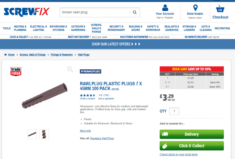

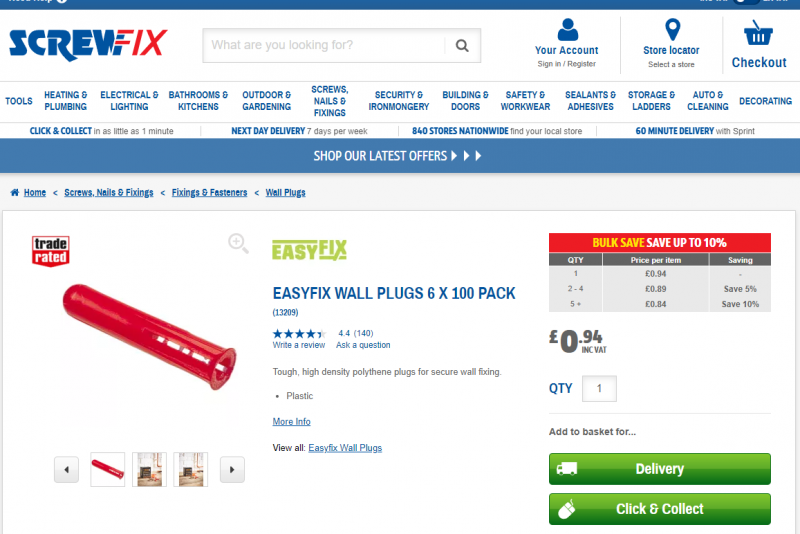

    Hi Dan
    It’s a difficult one to advise correctly because there are many variables to consider when fitting any sign.
    However, if you are fitting a length of aluminium angle to a flat concrete wall, then standard red or brown rawl plugs will do it.
    * Drill a 5mm hole in the brick approximately 50-70mm using a masonry drill and bit.
    * Insert the red rawl plug.
    * Screw through the angle into the plug.
    this will work for most standard-size pan signs. Obviously, you are looking for a snug firm fixing when doing so. if the hole crumbles or feels loose, insert a brown plug rather than a red one and tap in with a hammer.
    When you are installing larger pan or trim signs, or fitting to roughcast walls and the like. You will need longer screw fixings at least because you want a minimum of 50mm grip per fixing so due to the roughcast the screw must be longer as it needs to pass through the trim, the cavity the roughcast causes “then” 50mm into the wall.

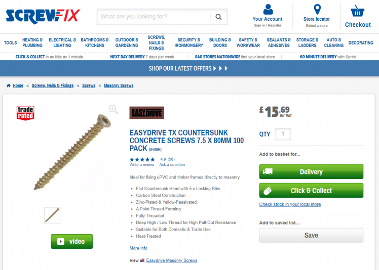

    When I fix larger signs, I tend to switch the fixings to concrete screws. Overkill, some will say.
    Whilst other times I “mix plugs and concrete screws” on long narrow pan signs too. and the larger the sign the heavier it becomes.

    I ended up finding my little box of goodies. It’s the red and grey wall plugs I use.

    I’d be more thoughtful as to what your fixings are made of ?
    Zinc coated & yellow passivated styles are only designed for interior/dry use, you need Micro plated or 316 (A4) grade stainless steel fixings for exterior work.
    TIMco do a good range of Multifix Concrete screws & Masonry screws but these are for dry conditions.
    TIMco Multifix Bolts are full exterior hence the difference in costs.
    I wouldn’t use the Screwfix ones shown as they are for interior use and only have a 12month warranty !!
    If you do need to use a plastic plug go for good quality brown size with barbs on not cheap smooth ones, stainless steel screws and a stainless steel washer to stop the screw head pulling through the ali.
