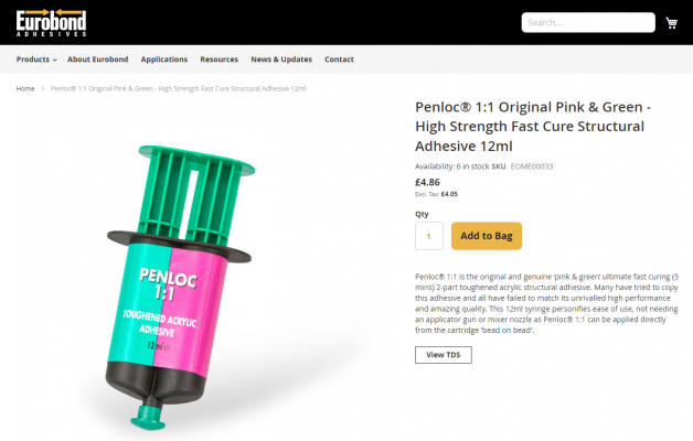

    We’ve always used Penloc 1:1R acrylic adhesive, for mounting snapfix to back of ACM letters.
    http://www.eurobond-adhesives.co.uk

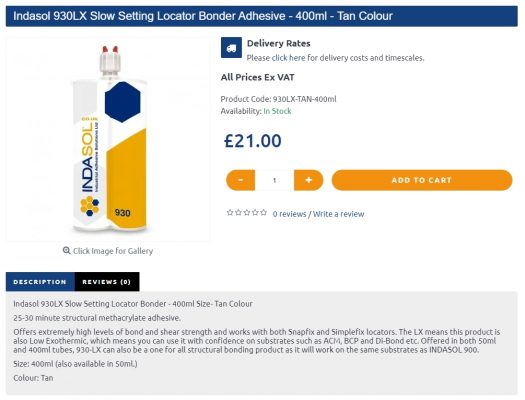

    I have always sanded where we put the locators and the back of the locator itself to give them a better bond, we use Indasol 2 part glues. I have had one or two failures in the past and these have been where the area was not sanded.
    https://www.indasol.co.uk

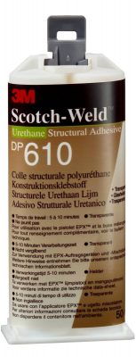

    I have always used the 3M two-part adhesive for bonding nylon locator fixings to composite.
    I am sure its the 3M DP610 code which is for bonding plastic and painted metal.
    I have tried some others over the years but found them brittle and that was just testing them in the workshop.
    As @CraigThompson points out, be sure to cross-score and clean properly before applying. it definitely makes a difference.
    @Colin-Crabb-1 I haven’t tried Penloc or the Indasol version, but I would certainly give them a go as I have heard them recommended in the past. I might actually give them a go myself. Because I like the idea of the one that does not require nozzles or a gun to use it.
