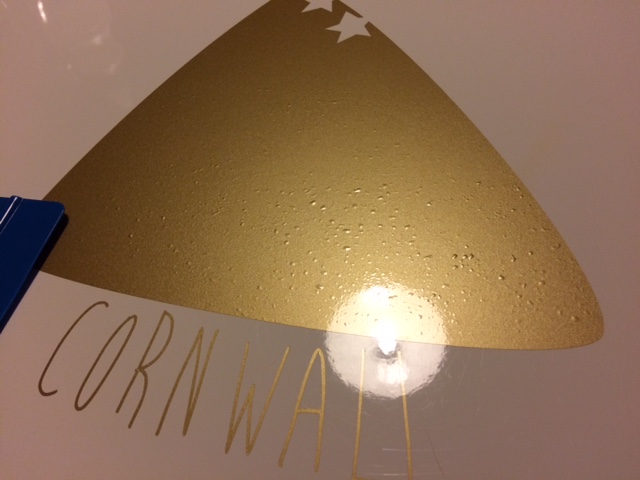

    here’s a photo of the ‘millions’ of bubble I got after removing the tape:
    Application was fine, cleaned with IPA before, flat as a pancake before removing the app tape. The bubbles appeared and seem to be pulled up at the edge of the application tape as I was peeling it back – stopped and gave it a bit more squeegee to see if it would improve for the rest of the graphic (peeling from right to left), but it did it all the way across the vinyl, assumed I was pulling the tape up at the wrong angle or not leaving the adhesive enough time to adhere beforehand.
    Incidentally the word ‘Cornwall’ there is perfect, there is also a web address out of shot that went on like a dream, white vinyl though for that.
    Appreciate you are all busy but interested to hear your thoughts…

    When you say pulling the tape UP do you mean up and away from the graphic? You should be keeping the tape almost flat to the surface and pulling it back across itself, hope that makes sense?
  • Mark Naylor
    April 7, 2017 at 10:42 am
    Yep, exactly as you describe; kind of figured it was that as soon as I’d finished, pulling the tape away from the face of the substrate too much… of course EVERY video I’ve seen online since shows the tape being peeled/rolled back on itself keeping it as flat as possible to the substrate, guess thats the secret right there – should have paid more attention, but thats the point of the practice go I suppose.
    Thanks for looking, will let you know how I get on.
    April 7, 2017 at 11:52 am
    That looks to me like dust under the vinyl.
    If you pop one of the bubbles does and press on it, does it disappear?
    When it’s air, I usually get larger bubbles & with poor squeegee technique I tend to see longer bubbles in the direction of squeegeeing.
    Not saying it couldn’t be air, but do it the same again and remove the app tape back on itself see if it’s the same?

    quote David Hammond:
    I’d agree with David. Could you have put the graphic on the floor (allowing it to pick up dirt) before applying. Did that a few times myself when I first started. :blushing:

    April 7, 2017 at 1:09 pm
    they look like bubbles to me…
    A good tip I heard many moons back (could very well have been from Rob….one of those obvious things that you sometimes need to hear)….always make sure the vinyl comes into contact with the substrate through the squeegee……never let the vinyl contact the substrate first and then squeegee over the top
    The letters have probably worked purely down to their size…not enough surface area to get air bubbles trapped in
    My guess is that you have placed the image on the van and then squeegeed over the top rather than starting at the top and working down whilst holding the graphic off the van until the squeegee passes over it
  • Neil Guppy
    April 8, 2017 at 9:36 am
    Any little dents or notches in the applicator edge? It needs to be perfect.
    None of the material should touch the vehicle unless it is applied with the applicator, as mentioned above.
    Some colours show up imperfections more than others- gold being one of them.

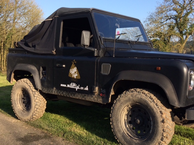

    Just wanted to say thanks again for all the tips on Friday, the install went really well for my first go :thumbsup:
    Peeling the application tape solved my bubble problem.
    My customer was very happy with the result so thats all you can ask for I suppose.
