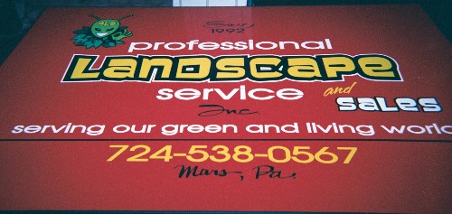

    Hi Folks.
    Just got pictures back today from Kmart.
    Besides the Graham truck in another post,
    I did a ton of red signs this month!
    I have 1 more tomorrow.
    At least I’m seeing a bit of green now!
    Love…JILL 😉

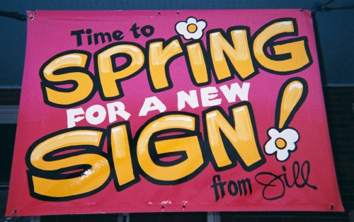

    Here’s another one….
    just a quick hand-painted banner.
    Took about 1 hour total. Cost=nothing! 😀
    I put it on my front porch & have been busy ever since!
    I cheated badly on this one. It is painted with a 3″ foam roller
    and a couple 1″ foamies. Completely non-traditional!
    Love…Jill
  • Bill Dewison
    March 17, 2004 at 11:45 pm
    Nice work 😀 How do you form the letter shapes though? Is it all done freehand with a brush or do you mark out with pencil? And how long does something like that take to dry? Am I asking too many questions and making myself look even more of a newbie than what I am? 😀
    Cheers, Dewi
    March 18, 2004 at 12:23 am
    No problem.
    I laid out the banner flat.
    I dumped a quarter pint of Rubine Red 1-Shot on the top half & rolled it.
    The bottom half got the same amount of Magenta. I left the middle blank.
    Then with the magenta roller, I gradually blended my way up into the Rubine. Took about 10 minutes. Left it dry 2 days as I was cheating with a non-enamel-receptive banner. (I would never sell this to a client)
    I got out my Mike Stevens book, peeked inside at one of his casual styles,
    then closed it so he wouldn’t haunt me after he saw what I did to his alphabet. Sketched it on real fast with a Stabilo pencil (water-soluable)
    Painted it with a 3″ roller and lemon yellow. Highlighted & outlined the whole mess with a 1″ foam brush. Left it dry another day. It took me longer to string it up with Bungees than anything else.
    This is the kind of style (or lack thereof) that works well on painted window splashes. Heck, I had fun, and it did bring me in some work.
    Love…Jill 😮
