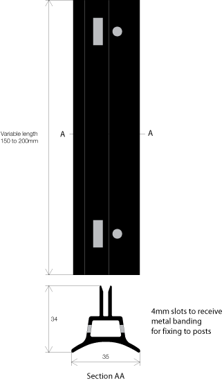

    Alan, you can get Y shaped brackets from signfix i think that has a couple of slots to take jubilee type screw banding, you can also get the banding and screw housings to cut to length yourself for various post diameters.
