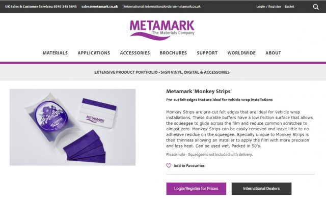

    Metamark sell packs and rolls of felt (Monkey Strips) great product.

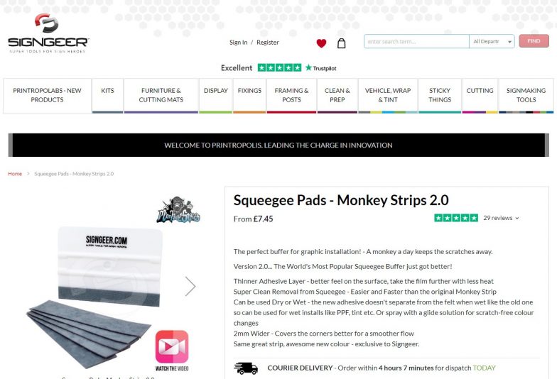

    As above Monkey Strips are what you need Karen,
    In strips or on a roll, I prefer the newer grey ones, a few places sell them.

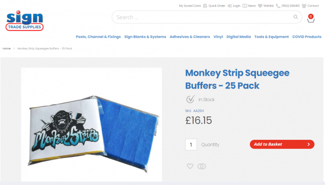

    Yes, banana buffers work best for me too. you can buy them from Sign Trade Supplies.
    25 strips for £16, not bad at all! 👍

    I guess Metamark use the purple ones as it matches their brand.

    Those ones sign trade supplies sell are good value for money. You can also buy Monkey Strips and Banana Strips, or the roll of strips from the likes of Amazon, Ebay etc.

    I think i will try sign trade supplies first because that does look a good deal.

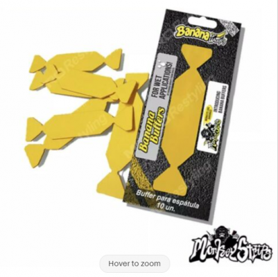

    We’ve just bought some “Banana Buffers” and can’t believe the difference a simple piece of felt can make! They glide over wrap material without leaving a single scratch. Use to buy eBay specials but never again.
    26 September 2022 at 12:03
    Banana Buffers are definitely worth having in your fitting box David.
    They are another product by Monkey Strips.
    They are primarily for “wet” applications, and by that, I do not mean water below the vinyl.
    Basically, you soak the buffer periodically as you install the wrapping film and it helps reduces micro scratches on the face of the vinyl which can happen very easily as your felt picks up surface dust and oils from the vinyl face.
    When I say soak, dip it into a small tray of way. then pinch your fingers over the strip and draw your fingers back taking off the water and leaving it damp. this ensures you have minimal moisture near the rear of the vinyl. and if you are wrapping, make sure you are handling the vinyl with “dry fingertips” as it’s so easy to get moisture on the rear.
