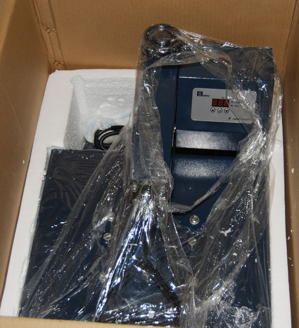

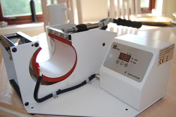

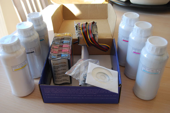

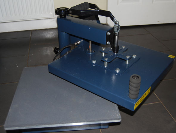

  • John Thomson
    May 29, 2008 at 4:54 pm
    Here are some photos now that everything is unpacked.
    The only thing wrong is the shape of plug top on the power leads but it is a standard PC lead and I have spares here anyway.
    Final costs were
    goods & shipping £705.01 ($1392)
    import duty £7.24
    Agents fee includes
    customs clearance £35.00
    airline handling £30.00
    DTi fee £10.00
    use of agents bond £5.00
    collection from airport £10.00
    import duty £7.24
    VAT £145.41
    Total excluding VAT £809.45 which I think was well worth the bit of work it took

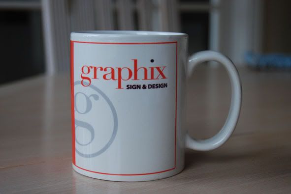

    OK the heatpress is working great so I finally unpacked the printer.
    After installing the Constant Ink Supply System (CISS) the printer software was showing the ink carts as empty……….pressing the re-set button clearly wasn’t resetting the ink level 😕 . After quite a few emails to China, all promptly replied to, I traced the problem to the little plastic pins that hold the ‘chip’ on the end of the ink carts……..it was protruding by about 1mm which stopped the chip contacting the printer…..so a quick slice with a scalpel and that problem was solved.
    Next problem was unbelievable banding when printing. I tried head clean and head alignment but traced it to the setting in the printer software that by default prints in ‘hi speed’ mode…….with hi speed off it prints as it should with no banding…………the prints look ‘washed out’ but this was the same as I saw at Sign UK with the demos.
    So next up is my first dye sub heat transfer………just going to look for suggested heat and transfer times to help get me started 😀

    190 degrees for 50 seconds on pretty much everything John.
    If its mugs the same temp for 3 minutes, but you may have to go through a few mugs to find your optimum dwell times for your press.
    Sublimation dark transfer paper 35 seconds at 185 degrees.
    Also download The SSC utility for epson printers, as your ink carts will show as running out from time to time, there’s a better head cleaning program in there and also gives you the option to clean either the colour head, the black head, or all together on a normal or powerful clean if they are badly blocked, also you don’t have to worry about the waste ink pad in the printer giving you a service error message as you can reset the counter.

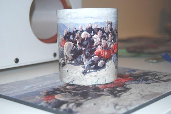

    Here is a pic of a full wrap mug and mouse mat………I really don’t think that profiles are going to be needed!!!!!!!!!!……..I have to say that I am delighted with the results and fully expected it to take a LOT of messing about to get to this stage……this was the third mug and the third mouse mat………..just messed with dwell times………thanks for the pointers Steve 😀
  • Steve Underhill
    June 8, 2008 at 11:02 pm
    Nice work John, looks good.
    Especially so if youre not using profiles, you usually get really washed out colour but they look great.

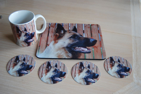

    Here is a photo of a mug, mat and coasters that I printed of my dads dog Tanya……….I think the colours/finish are pretty good?

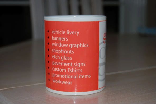

    Here is our ‘promotional’ mug printed with the above settings…….I think the solid colour is a far better test than a photo as any flaws are very apparent.
