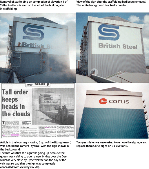

    Hi all – I thought that in light of the news that Corus could be closing one of their remaining sites in the uk I would show you the signs I made and fitted at Shotton Steel works (Deeside, North Wales) which could be the unlucky one which has to close it’s doors.
    The signs were all hand cut (by me and a jig saw) out of 3mm Aluminium sheet (56 off 8’x4′ in all). They were then powder coated in the relevant RAL colours and lifted into position in pieces by ropes and shackles.
    They were rested on temporary ledges made from 3/4″ ply with strips of ali screwed to the front, (overlapping the top edge), as an anti-slip device.
    The sign pieces were then fixed into place using 4.8mm (100% aluminium) rivets – the positioning of the signs individual pieces was done purely by using measurements from scaled up drawings and transfering them to the side of the building, (plus a great deal of prayer).
    The rivet heads, (many thousand of them), were then touched in with the matching paint.
    The total height of the sign was 120ft from the floor – we were working on lightweight aluminium scaffolding standing on the shed roof below which reduced the height to about 70ft.
    The red tape involved with working on a site like this meant that up to 2 hours a day were spent chasing invisible site managers trying to get your permit to work signed (in and out) – given that we had 3 weeks in total to manufacture and fit the signs you can guess the mood I was in most mornings after sitting in an office, (resembling the Marie Celeste dining room), waiting for a sighting of the lesser spotted shift manager to beg him to sign the afore mentioned paperwork.
    Add to this that the time of year was Jan / Feb and very very cold – you could say that we were glad when we finished………….
    ………The British Steel signs were up for approx. 2 years then we were we asked to remove them and fit the Corus signs – how could we refuse?.
    Anyway – have a look at the picture below

    Did you say it was scaffolding throughout or were you working from towers (?) (?)

    that sort of work must be a nightmare to cost

    im glad you fitted the corus and not british steel, asi t looks off centre. 😮 😆 😆

    Where do you start trying to price a job like this ?

    Well, Robert, we actually did both signs;
    The British steel (I’ts not off centre by the way – it’s a trick of the light- honest) AND Corus .
    The initial job was done 2 years before Corus bought them out so we had to remove the Brit Steel one and put up 3 Corus signs.
    Costing it was not as bad as you would think, suprisingly, but we got more for taking it down than we did for putting it up (and what a weigh in – exactly 1 ton of aluminium).
    The entire area was scaffolded – but it was very bouncy up there and took a bit of getting used to – especially after we all got food poisoning from the BritSteel canteen – LOOK OUT BELOW! 😳 .
