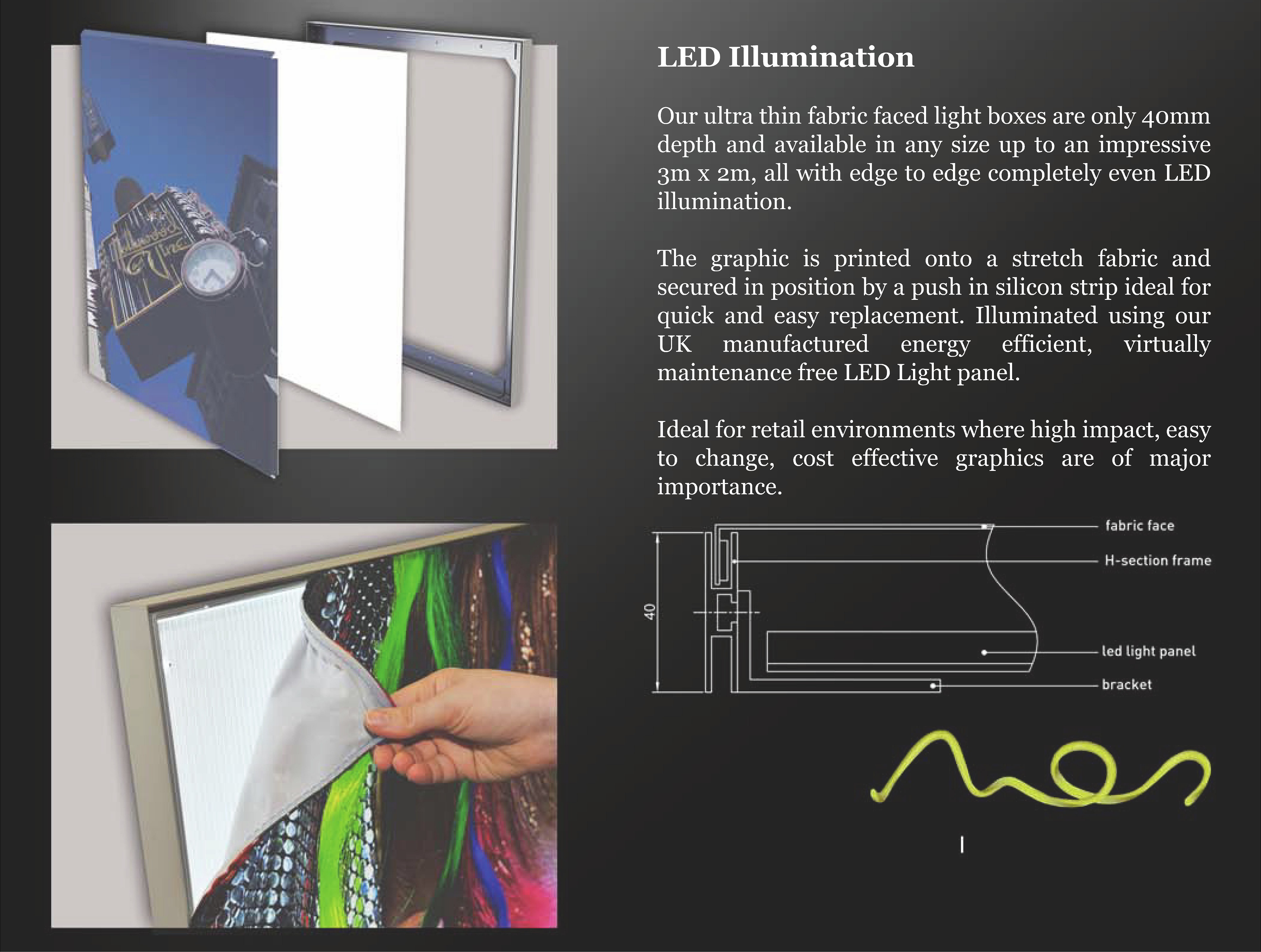

    Hi Andrew,
    I’m not sure what standard is to be honest. I think it is exclusive to them. All I currently have is a tech drawing I was given by Architects who specified the system & an image from their own website here:

    March 23, 2018 at 7:14 pm
    Looks to be standard fabric print.
    Need to make sure you use the correct size silicone 10 or 14mm. You just need the size of the unit + the size of the silicone strip. Whoever you buy the print off should know how much smaller to make the print(dependent on what fabric they use) to ensure correct tension
