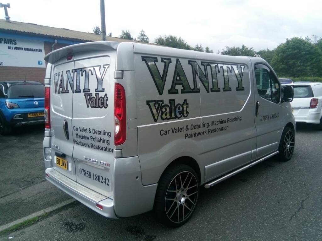

    I have a customer looking for chrome vinyl lettering on his van.
    Can anyone suggest a quality material at reasonable cost? Just fitting to flat panels on a Vivaro

    I spoke to Europoint and will go with their recomendation….a new R tape material.
  • John Thomson
    June 17, 2017 at 10:17 am
    The R take material worked well….. Very metallic….like thick kitchen foil.
    Customer loved it which is the main thing.

    June 20, 2017 at 11:59 am
    I was surprised….. Cutter pressure was the same as for normal vinyl and I have continued using the same blade so there may have been a little extra wear on it but certainly not much.
