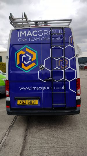

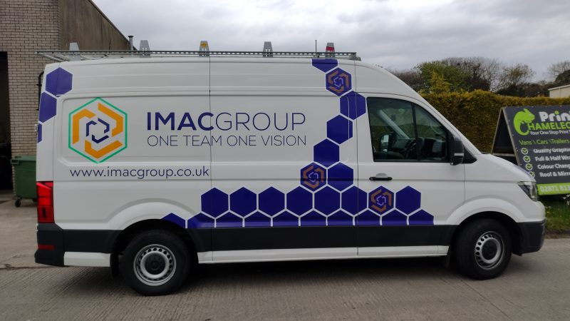

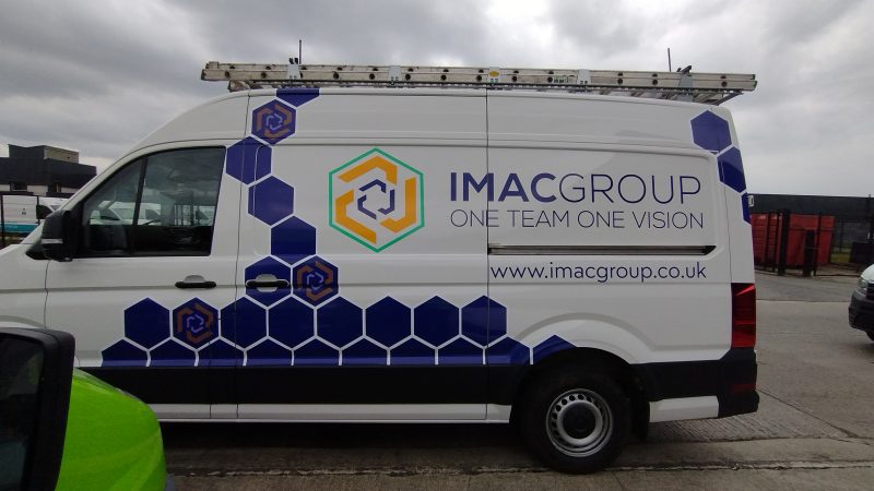

Posted by David Stevenson on April 26, 2023 at 9:19 pmHi, what’s peoples thoughts on how this vehicle should take to complete with one person working on it, taking into account all the graphics would be prepared and ready to be applied? Vehicle would need cleaned first with surface cleaner as they’ll all be washed prior to arrival. We’ve possibly 14 of these to do so would be interested on what other peoples timescale would be.
Many Thanks, David

Obviously, you have the strip down of the rear, and remove the plate, ladder etc.
But one man, I would allow for one day’s labour.

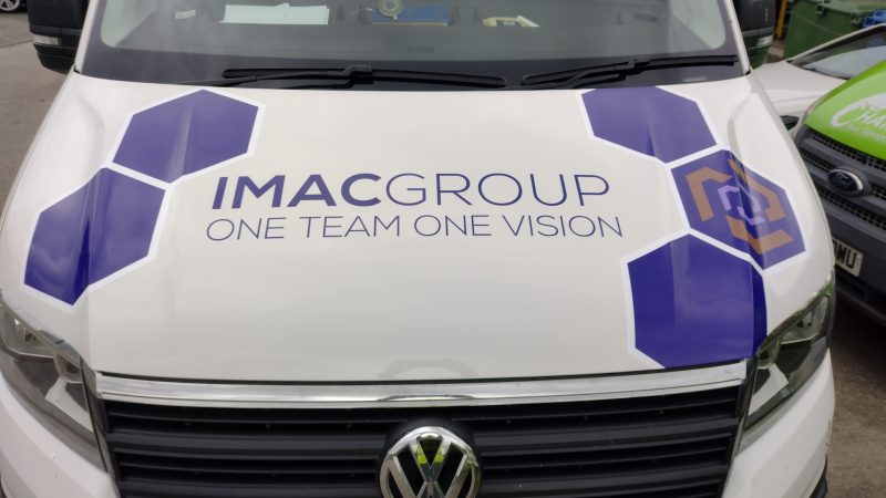

The rear doors will obviously take the longest. The bonnet will take less than half hour.
I’d say a maximum of 2 hours on both sides which leaves you 5 and a half hours to get the rear doors done in an 8 hour day.

Good to hear people opinions. 1st van I done took approx 11 hours. That included me having to weed and back up all the graphics before cleaning the van & fitting. We’d a bit of an issue with a few extra cut lines on the bonnet which has since been resolved. We’ve another 14 of these to do now so the plan is to have one of our other guys prepare the stuff leaving me to get stuck in with the fitting side of things. Going to be a busy few weeks it seems 🙂

4 hours for the removal of parts and wrapping of the doors. you have the remainder of the day to fit the sides and bonnet. the side has fair coverage but all those hexagons are not being wrapped, so should be easy enough. a decent order to get! 👍
