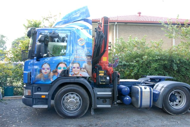

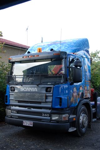

    did this all on my own 😮 I think I’m getting too old to be climbing all over trucks.
    This is the baby, the next two are HUGE 😮
    The graphic designer made some fundamental errors which I couldn’t change.
    I was given the artwork for the first and only time when the driver handed me the keys. They only gave me 2 days to complete the job before it was needed back on the road for deliveries.
    Not my best effort, but I was pleased with the result given the circumstances.
    All 3M 180CV2 and Laminate

    July 2, 2009 at 11:15 pm
    Certainly looks good from the pics mate, and well done in 2 days,
    was it a full wrap? or print and cut the pics? hard to tell from the photos
    July 2, 2009 at 11:20 pm
    quote Peter Normington:
    Thanks Pete, a full wrap mate. The truck is white….
    July 2, 2009 at 11:33 pm
    In that case an exceptional job, the 3m is very glossy,
    so forgive me for thinking it it was paint

  • Jason Xuereb
    July 3, 2009 at 5:13 am
    Awesome work.
    How did you go around those air intakes?

  • Jon Marshall
    July 3, 2009 at 8:05 am
    It’s those wind deflectors that are a killer! Good job.
    July 3, 2009 at 9:52 am
    July 3, 2009 at 9:58 am
    Thanks friends,
    Jason, the air intake is in one piece. The 3M wraps this beautifully. Its excellent stuff to work with in this situation.
    I’m looking forward to using the new 3M180CV3 material as its adhesive is supposed to be more aggressive for recessed areas.
    The only area I spliced was the wind deflector because the designer stuffed up on the measurements, so I had to move the ends 3 inches back.
    I tried to cut it on the curve so it would be harder to see, but it still looks ‘out’ if you examine it closely.
    The wind deflector took me the best part of one day by myself. I was knackered at the end of the 2 days.
