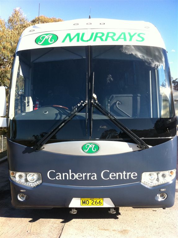

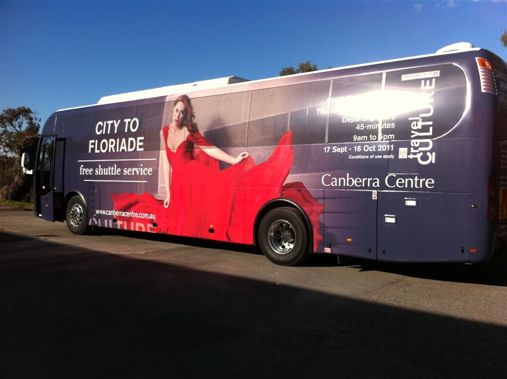

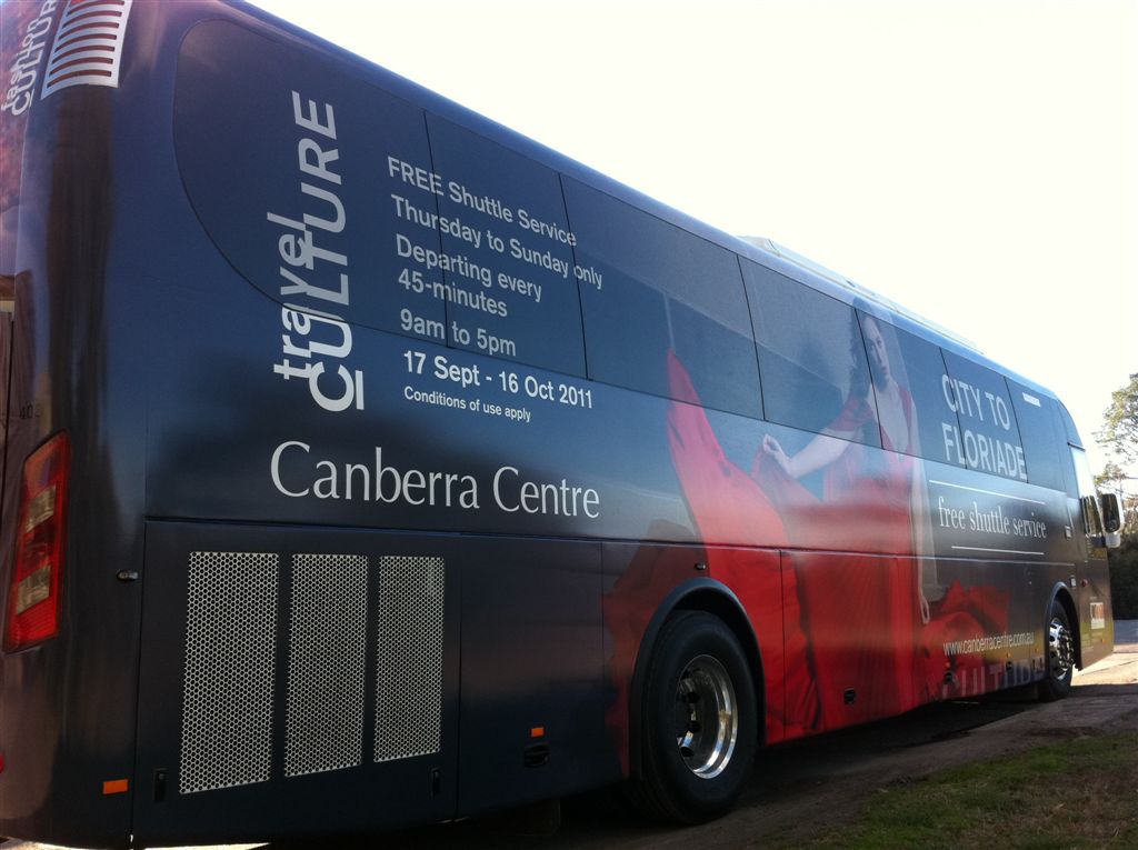

    Posted by Shane Drew on August 29, 2011 at 1:11 pm
    Here is another wrap done last week. 15 hours driving to the job (1200klm’s), 4 days fitting, and 15 hours back home.
    3M material on the bus, ‘legal’ one way vision on the windows.
    All done dry.
    Design was by a graphic artist who had never designed a wrap before. A few minor mistakes, mainly with the layout, but we managed to correct those on the fly.
    Client was well pleased, and have already nominated us to wrap another 2 buses next year.

    Top Notch work again Shane, well done my friend.
    The layout is very good, very effective.

    Nice……. always a pleasure to see your work Shane… what width is that lot printed at?

    great work Shane as always mate, very nice design and works well on the coach. far too many dodgy wraps going around these days. nice one mate.

    I like the layout too and I’m usually pretty picky.

    Thanks friends…. I seem to have found niche market, purely by accident. All I seem to do is Trucks and Buses now.
    Mo, I use the horizontal panels to hide the long joins in the panel joins. I lay horizontal, not vertical as a result. On this 12m long bus, we did each panel 3m long x the height of the panel, so the windows were 4 @ 1100mm high x 3m, the panel under was 4 @ 900mm x 3m, the roof was 4 @ 300mm x 3m (combined on the one print) and the bin doors were 4 @ 1250mm x 3m panels.
