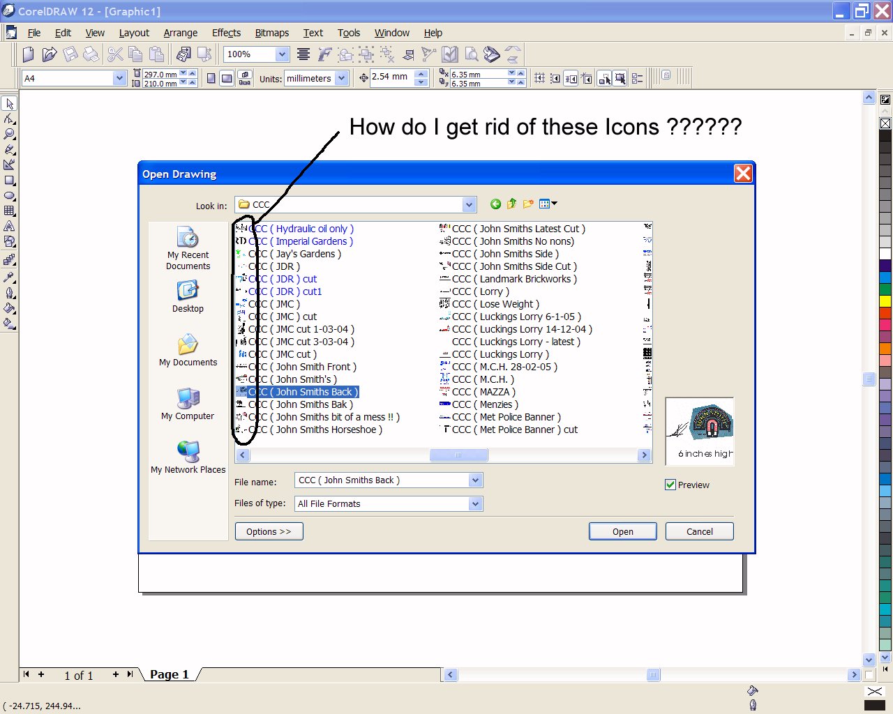

    Does anyone know how to remove the little icons from the Open Drawing option ??? It’s driving me Mad, as it takes so much longer to browse files with them there !!!
    I recently upgraded from Corel Draw 9 which didnt have this problem !!
    Please – somebody " Help Me " 🙂

    this should do the trick. is from a previous post
    To remove the thumbnail display, do the following:
    1. Go to the Add\Remove Programs in the Control Panel.
    2. Select CorelDRAW 12, then highlight Change.
    3. Select Modify and click Next.
    4. Click the plus sign beside Utilities.
    5. Click the down arrow beside Thumbnail Display (CDR/CPT) and choose ‘This feature will not be available’.
    6. Click Install.
    7. Click Finish.
