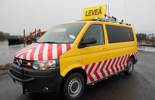

    Also why ive got you guys here 🙂 this is the job im wrapping, but its an LWB sprinter.
    With regards to the chevrons, im assuming in this day and age everyone prints them onto reflective wrap film?
    TIA

    March 15, 2022 at 6:55 am
    Don’t know if it’s industry standard but it’s probably the way I’d do it, bonnet would be against the regulations if it’s reflective red at the front though. Do you have similar rules in Finland?

      March 15, 2022 at 7:57 am
      Rules are that on the front its not doesnt need to be reflective red and on back doesnt need to be reflective white but red needs to be. So………….

    I have printed engineering-grade chevrons like this onto Oracal reflective and laminated it, a few times and cut it as a kit, rather than a wrap. works perfectly fine.

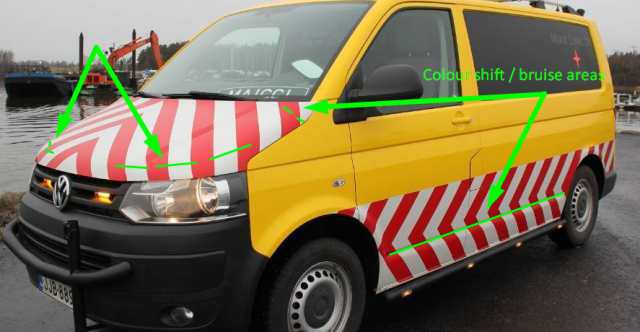

    However, it is that bit thicker and less conforming. The general application is straightforward enough but what you need to be extremely careful for, is blemishes and bruises in the reflective. it is basically how the reflective vinyl is made up, and when it’s stretched you get an irreparable colour shift in the vinyl, not the ink!
    The area indicated along the side may bruise, but the change in shape due to the recess will hide it. however, in the areas of the bonnet, it’s facing you and the sun shining off it, so it’s an area where you need to make sure you don’t crease or stretch or bruising and lines may appear.
    You may want to consider using Arlon reflective wrap for this. It won’t stop the bruising, which will happen regardless of the brand, but it has their flite adhesive system so it’s much less aggressive and forgiving adhesive system. And lets you focus on what you are doing with the reflective, rather than having to snap it up and down continually with the risk of bruising.
    What you should do, is just go to your customer’s premises and have a look at how their existing vehicles are done. The trouble we often have is that we are trying to offer a perfect solution, when they may be currently accepting a dogs-dinner!
    I am not suggesting you offer a similar meal, but it is so much easier to offer a better approach to the job, explaining the limitations like bruising etc or, you do what they currently have but make a neater job of it.
    * It could be that they do have it wrapped, but the chevrons aren’t reflective.
    * The chevrons might be reflective, but its individual cut lines of engineering-grade reflective fitted one line at a time.
    * Are both white and red reflective or just Red?
    Just some thoughts…
    A sprinter is a decent size van, use a good brand of wrap that will speed the application up for you.
    If you do have to wrap the chevrons, use Arlon reflective with flite adhesive. Or Oracal reflective, but less forgiving adhesive
    Time saver and money saver for your customer, wrapping the roof is pointless with all that kit on top.
    I don’t know what this vehicle is used for, but its colour, the markings, lights etc suggest its all about safety and they will know a ball-park figure for these type of jobs and will know its not cheap.

    March 15, 2022 at 4:27 pm
    Martyn
    If the white doesn’t need to be reflective mate, just wrap it white and apply the cut red reflective chevrons on top.
    • Martyn
      March 15, 2022 at 6:35 pm
      Thanks rob, yes it does need to be reflective, apart from the back.
