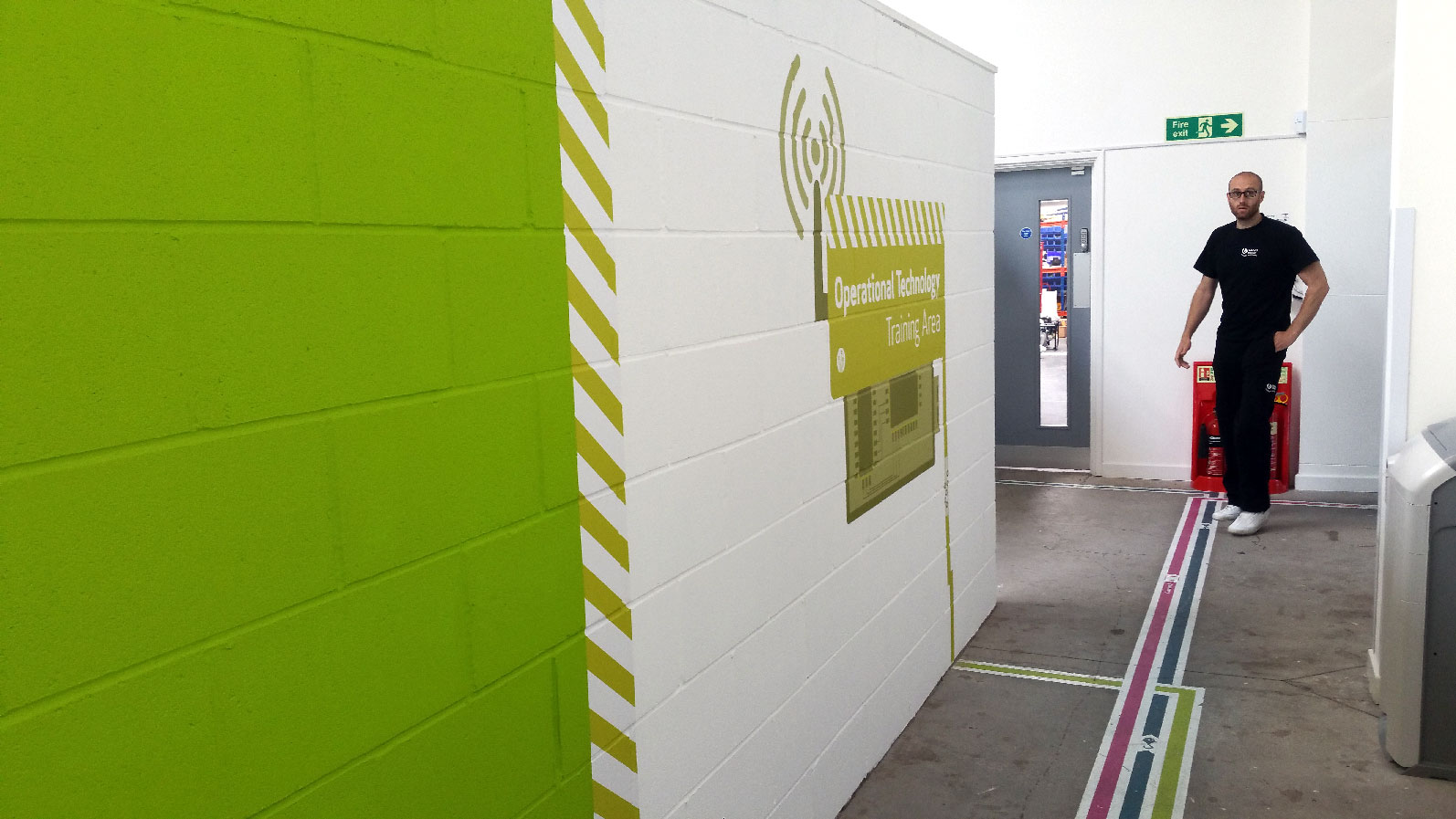

    August 18, 2016 at 1:39 pm
    TaDa!
    Installation done this morning, took 80mins from signing in, to signing out.
    Chevrons in 2 pieces, and the large graphic is in 3, the larger part is spit in two, and the line running up a separate part.
    Really impressed with the DPF8000 :thumbsup:
    I don’t know who that guy is… :yikes:
  • Iain Pearson
    August 18, 2016 at 7:20 pm
    Looks great David, well done.
    Glad you got on well with the Arlon, it’s a great addition to your stock items. Also gives you confidence the more you use it. Nice work [emoji106][emoji106]
