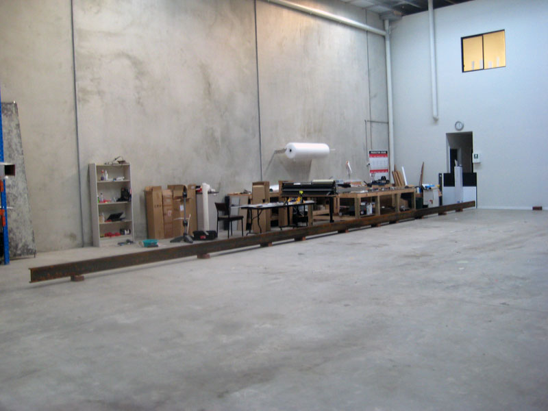

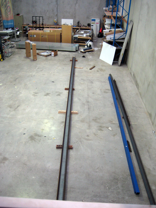

    Thought you guys would enjoy watching this take shape.
    Got my steel today for the new print room and mezzanine floor level.
    Also ordered the cleats to get done laser cnc and the purlins as on their way also. Concrete cutting guys coming in next week to reinforce the slab for the posts. Hopefully we can also get welding as of next week and get this up the week after.

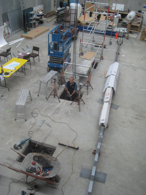

    Still going 😀 Got the council approval for the holes we had to cut out in the slab. Welding should be finished this week and we get the structure up next week. Dragging on a bit I guess this always happens.

    4 August 2009 at 11:31
    Here you go Mr Cleary.

    the secret basement is uncovered!
  • Jason Xuereb
    4 August 2009 at 11:39
    I think we nearly hit England while excavating.

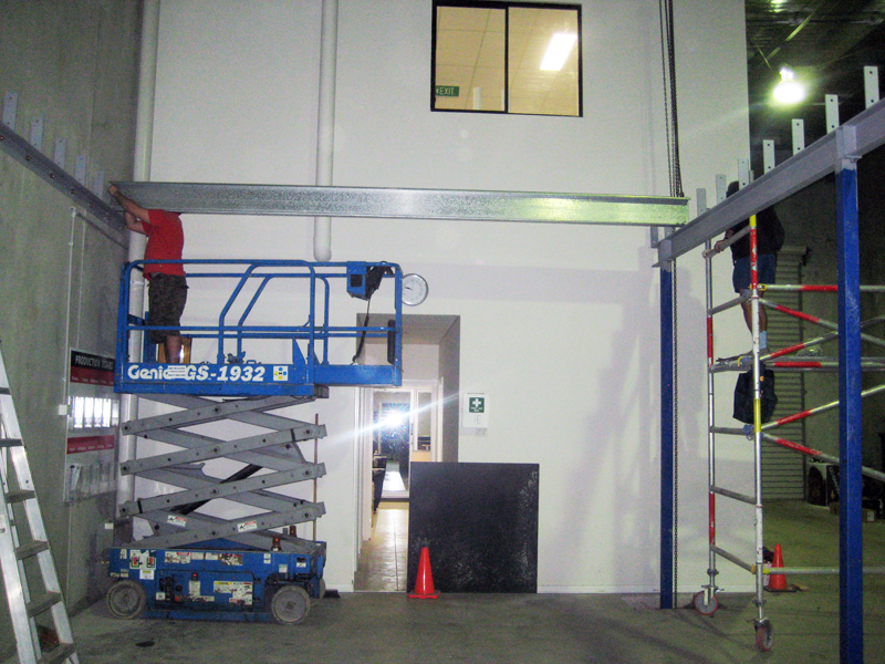

    7 August 2009 at 05:22
    Up she goes. Finally coming together now. Just need to wack all the purlins up square and level it then concrete the posts in. I enjoy doing this work actually building something.

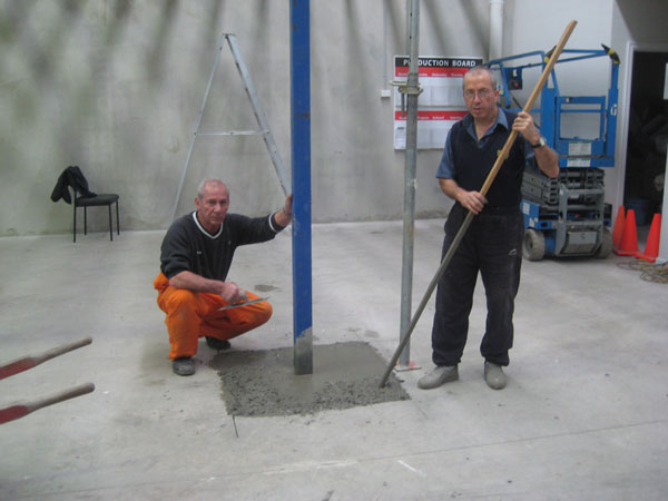

  • Chris Dowd
    8 August 2009 at 15:27
    Curious as to why you concrete the legs in Jason?
    Over here, our mezzanine floors are bolted through base plates into the concrete slab.
    Look forward to seeing more pics as it progresses.
  • Jason Xuereb
    9 August 2009 at 02:37
    quote Chris Dowd:
    Hey Chris. It has all to do with the permit down here. Because I only have 7.5 car spaces in my car park I am not allowed to have any more office space. So the extra space on the mezzanine level is considered storage space. This means it needs to take a load of 35 tonnes on the top. The engineer gave us the option of having really big metal plates on the bottom of the posts or putting them into the ground. I didn’t want the plates getting in the way (walking over them etc) so we went with putting them in the ground.

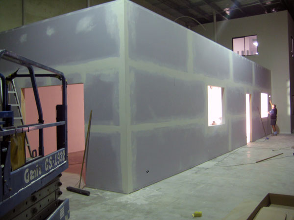

    28 August 2009 at 14:35
    Been busy with work. But the timber frame is up. All the plaster is hung. The sparky has run his wires.
    Blocking up the plaster tomorrow. Should have good progress made within a week.

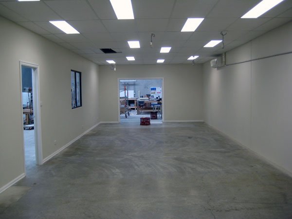

    15 September 2009 at 03:25
    Nearly there. Paint the floor and were moving in.
    Hurahhhhhhhh (:)

  • David Rowland
    15 September 2009 at 11:16
    wow… nice work, hm… lights look a little yellow, dont know if u spied the lighting thread the other day 😉
    15 September 2009 at 11:21
    quote Dave Rowland:
    Good Grief Charlie Brown! 😕 😉
    loving the progress Jason, top notch mate… well done!
  • Jason Xuereb
    16 September 2009 at 02:01
    quote Dave Rowland:
    All Cool White Dave standard office tubes.
    I’ll put a 5000k light in somewhere or get a viewing booth.

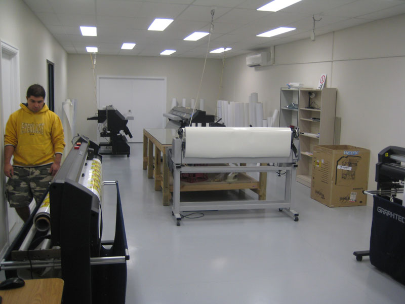

    6 October 2009 at 00:22
    ok Just some quick snaps. Still want to put in a few things but Jamie had the camera out and took a few snaps.
