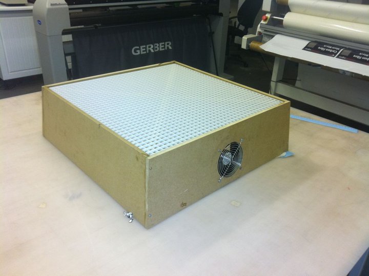

  • Kevin Chapple
    July 18, 2011 at 9:11 pm
    Thank you for the feedback I decided to make my own out of MDF. It seems to work well.
    PS. Am getting someone from a local GRP company to quote to produce it if anyone is interested
  • Jason Xuereb
    July 18, 2011 at 11:26 pm
    Shouldn’t the air flow be going from the top to the bottom of the rolls?
  • Kevin Chapple
    July 19, 2011 at 6:45 am
    Yes I think so as the ink vapour sinks.
    The fan is set to suck from the bottom.
    It seems to work well as you can smell
    the vapours coming out the fan.

  • Gill Harrison
    July 19, 2011 at 8:07 am
    Hi Jason
    Air flow is the important thing. Getting plenty of air circulation to move the solvent away from the print.
    Yes a fan at the top would be ideal. In fact a fan blowing down through a print and one at the bottom extracting would I’m sure be really effective, but I loved the simplicity of this system and the fact that it is very easy and quick to construct.
