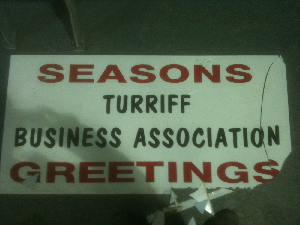

    Ive been asked to make 4 light box fascias double sided so 8 in total. In the past they have been made of what looks like 2mm white perspex sheets. is this a normal materiel? Plus the reason they are broken is because some little sh1ts have decided to throw stones at them!! yeah very festive! Is there been a better type of materiel? eg unbreakable! Cost more at the start but will save money in the long term! or am i doing myself out of future work here?
    Martin
