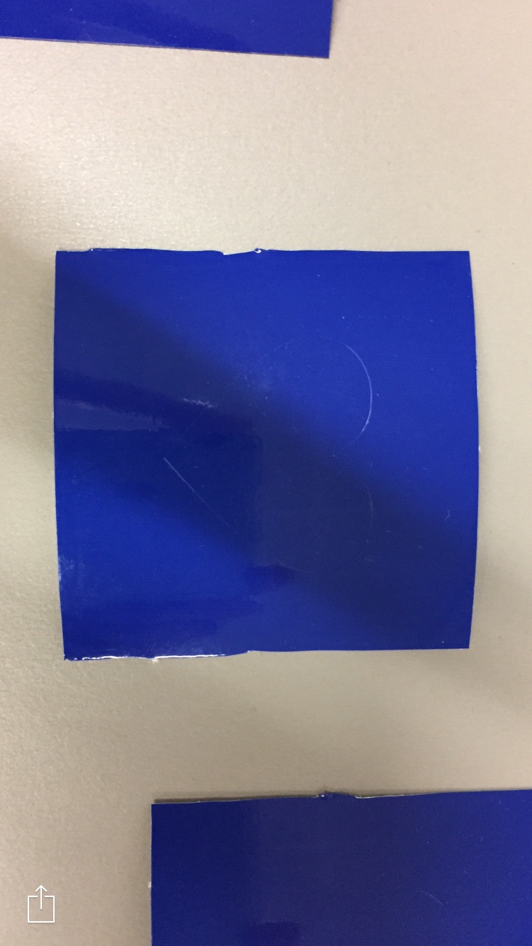

    im still having a little trouble with this die cut job, i run a few test cuts before i started the job to sort out cut pressures, i got that sorted.
    so i sent the job to the machine to cut, it cute one side really nice but the other side is cut really rough and hasnt cut all the way through, coult this be down to the cut line shape? maybe a bit too complex for the machine to cut all the way through?

    In the cut setting on Vera’s works next to the pressure for the depth there is the distance it would cut (right above) in a oner. Our versaworks came set at 50mm, the engineer instantly advised taking it down to 25. Am pretty sure he said the reason was to produce a cleaner cut

    I can’t say I have ever tried to cut all the way down through the backing paper. That’s not to say it can’t be done, but I would have thought it would blunt the blade incredibly fast.

    Our graphtec can cut through the backing, using a felt cutting strip. We use blunt blades for it, rather than a sharp one.
    Trouble is it isn’t a clean cut, so we cut & weed leaving reg marks, then run through again to perf cut.
    A knack in getting it so they remain in the sheet otherwise the pinch rollers will jam where the holesender are.

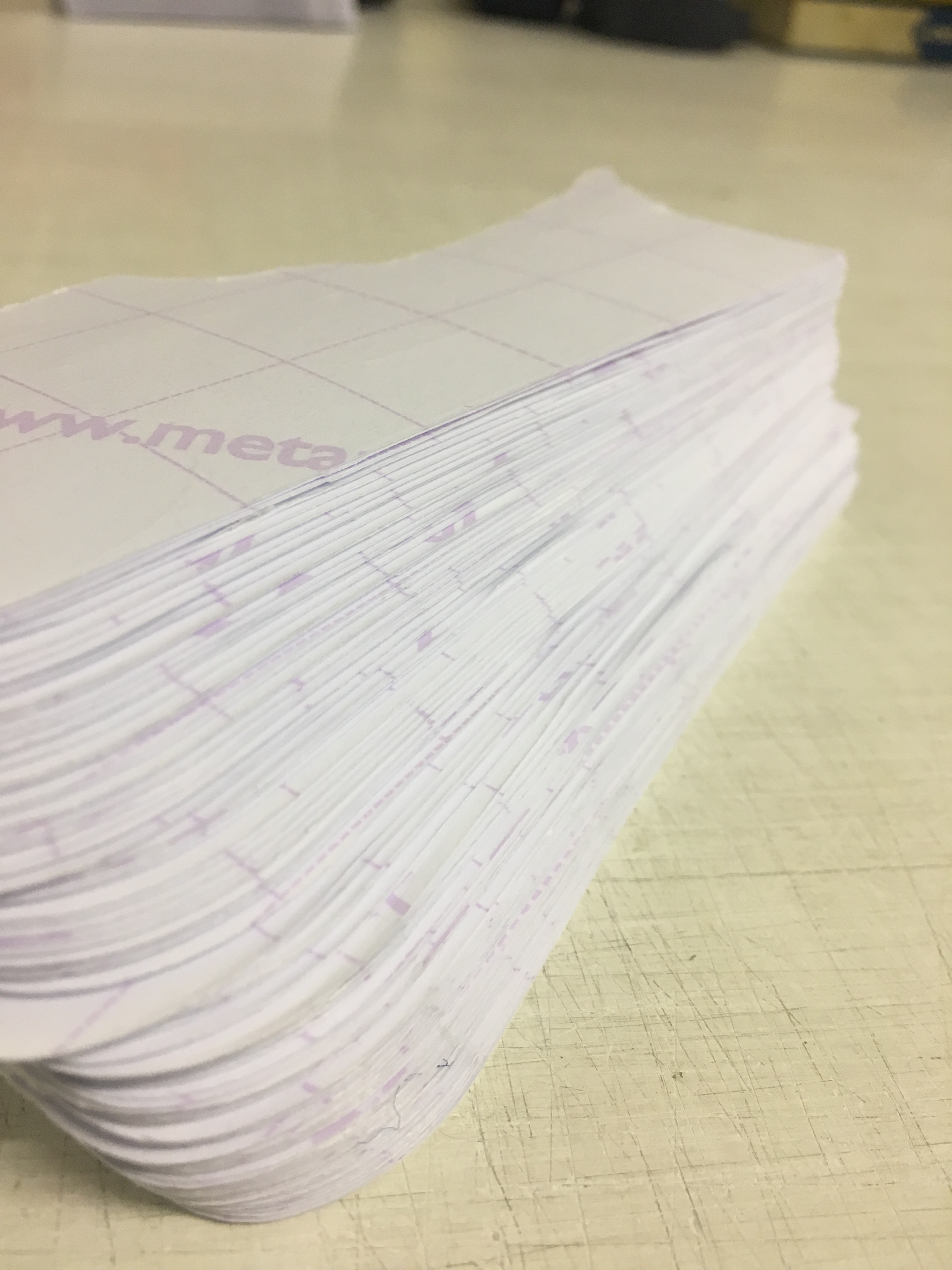

    Hi rich, I did a few thousand of these last yr, I cut them on my Roland xc540 and my Roland gx500, took a bit of playing about with pressures etc ( I did one at a time with some old vinyl and laminate) to get it right but once I perfected it they cut lovely, I did the die cut through vinyl then had about a 3mm border which then perf cut through backing and they just popped out, giving a 3mm border made it easy for client to peal sticker when applying instead of getting caught on edges, what equipment are u using and software?, hope this helps in some way

    Thanks pane, a lot of time and effort involved in getting it right but once right great results, usually I’d agree I always die cut and leave rectangular shape background but this was a huge manufacturer that gives them to reps and there wholesalers so insisted on perf cut, thanks again for nice words.
