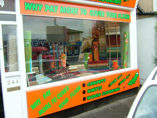

    September 28, 2004 at 5:07 pm
    design is from there letterheads (i know what your thinking) but customer over the moon with it
    rich

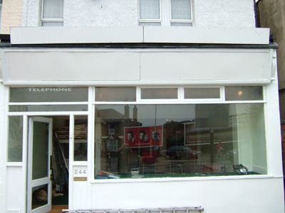

  • Richard Urquhart
    September 28, 2004 at 5:14 pm
    befor
  • Carrie Brown
    September 28, 2004 at 7:37 pm
    :lol1: I just got the rem-it rem-it bit …. its the sound the frog makes …… thats why theres a frog there … and the rem-it is for remnants …. :lol1: Or have I lost the plot and Im wrong 😮
    You did a great job of the tray Rich, overall finish of the whole sign is certainly eye catching.
    Carrie 😀

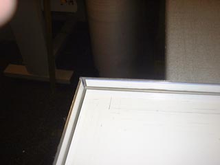

    September 28, 2004 at 8:20 pm
    The trays look excellent.
    How did you eventually fasten the corners?
    I believe the manufacturers of dibond publish a guide to producing these types of trays with a recommended method of finishing the corners (which is difficult to describe but which makes sense when you see the diagrams).
  • Richard Urquhart
    September 28, 2004 at 8:29 pm
    thanks all the corners are glued with 2 part automotive bonding glue ,which is as strong as nails

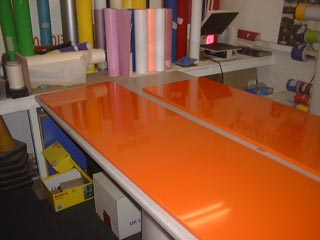

  • John Singh
    September 29, 2004 at 7:04 pm
    Smart work
    Those corners are really great
    Couple of questions (when you’ve got an hour or two spare 😀 : )
    Did you use a router with guide and the ‘V’ shape?
    How eventually did you bend it over along it full length?
    ….and the corner did you file or sand smooth after bonding?
    I’m keen to have a crack at this………hence the questions
  • Richard Urquhart
    September 29, 2004 at 7:31 pm
    john hi mate i didn’t use the v bit just a normal round bit ,you know the d i y sort of thing
    once you have got the depth right i.e thought first sheet of ali and part way through plastic the dibond bends so easy its a real dream to work with

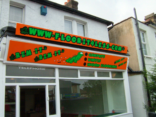

  • Richard Urquhart
    November 12, 2004 at 12:46 pm
    well this is it all finished i have been busy so had to keep customer hanging on not good i know but he was well happy today when it was all finished

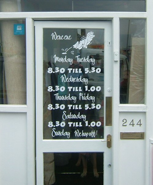

  • Richard Urquhart
    November 12, 2004 at 12:48 pm
    door
  • Alan Drury
    November 12, 2004 at 12:53 pm
    I like that script font on the opening hours, what is it?
    Alan
  • Richard Urquhart
    November 12, 2004 at 12:55 pm
    snappy dna
  • Dale Horn
    November 12, 2004 at 4:56 pm
    Call the fire department ! One things for sure if they ever get lost- it will be easy to find them. 😮
    Nice job on the dibond forming (the corners look nice and round in the second picture)

  • Andy Gorman
    November 12, 2004 at 5:02 pm
    Love those colours, man. The folded panels are something I’ve long wanted to have a go at, must get round to trying this as it looks very tidy.
    Dynamite, did you ever get your van done? I seem to recall you were playing about with designs for it a while back.
  • Bill Dewison
    November 12, 2004 at 5:07 pm
    Certainly some dynamite signage there! 😮 Really like it and the opening times on the door are fantastic… ‘we’re ere’ & ‘we hop off’… classic!
    As Andy says, the colours are brilliant, and when you compare it to the before piccy, it shows just what a transformation you’ve made. One for the porfolio. 😀
    Cheers, Dewi

  • John Cornfield
    November 12, 2004 at 7:52 pm
    Sorry for being a thicky.
    Anyway we have a cnc router and have never used diabond but are looking to work with it.
    I can see from the photo you rountered out about 50mm from the edge to fol to the side. I can see you have cut out the diagonal piece for corners. Did you cut completely through the corner diagonal?
    If you did cut through when you fold does the aluminium split?
    You siad you used an ahesive to join the corners so i guess you split the corners. Does that mean there is an obvious line.
    When you bond the corner are you joining edge to edge and glueing.

    November 12, 2004 at 8:54 pm
    i like the continuation of the theme right onto the door also mate.
    only thing i would suggest is to drop the overall size of the door info by 20%… just my thoughts on it.
    the signage on a whole is very in your face due to colours etc. it works, as its obviously what the customer wants. the door, although spot on for what he wants kinda draws it out a bit. not the design just the size. its a bit overwelming when you veiw everything as one.
    damn.. now i am making it sound there is something up? theres not mate. just trying to put some constructive critisism to you.
    one thing for sure is, you have come on leaps and bounds in your work & fitting. glad you have kept us upto date on your work.

  • Richard Urquhart
    November 13, 2004 at 4:22 pm
    thanks all Rob your memory is tops that was the first help i asked for and along with every ones help came out good too
    John hard to explain mate i routed the same distance on all four sides then when you bend you only have to remove the small square and corners meet ,i then key up behind corner and use 2 part glue if you cut the square out well the corners butt together and joint cant be seen
    Iam very lucky as i run a car body shop things like air saws and d a sanders come in so useful in this game ,i use the air saw with a fine blade and it allows me to cut through dibond like butter
