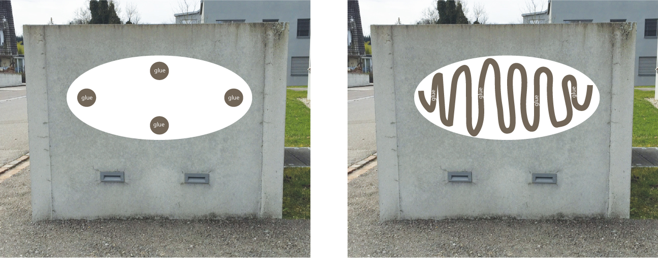

    This is a first time for me where I need to glue dibond sign to super flat concrete. (I’m not allowed to drill)
    What glue shall I use please?

    Shall I pay attention on how shall I distribute the glue? (brown is glue on the photo)

    Pane
    Siroflex.
    Roughen the back of the ACM and CLEAN the concrete.
    apply the adhesive in vertical lines so the water that gets behind it can drain away.

    Pane
    3M do a VHB tape along with a concrete cleaner/activator
    We did the whole of a well known football stadium
    A few years ago – fantastic stuff

    We’ve used a product called ct1 I think, most plumbers merchants sell it.
    Sealant/ glue.
    I think not matter what u use you’ll have to support it while it sets or it might slide down

    Also used ct1 and used a white putty type one made from tech7 which glued 2mm aluminium panel and has stayed in place for 3years already and has been regularly power washed
