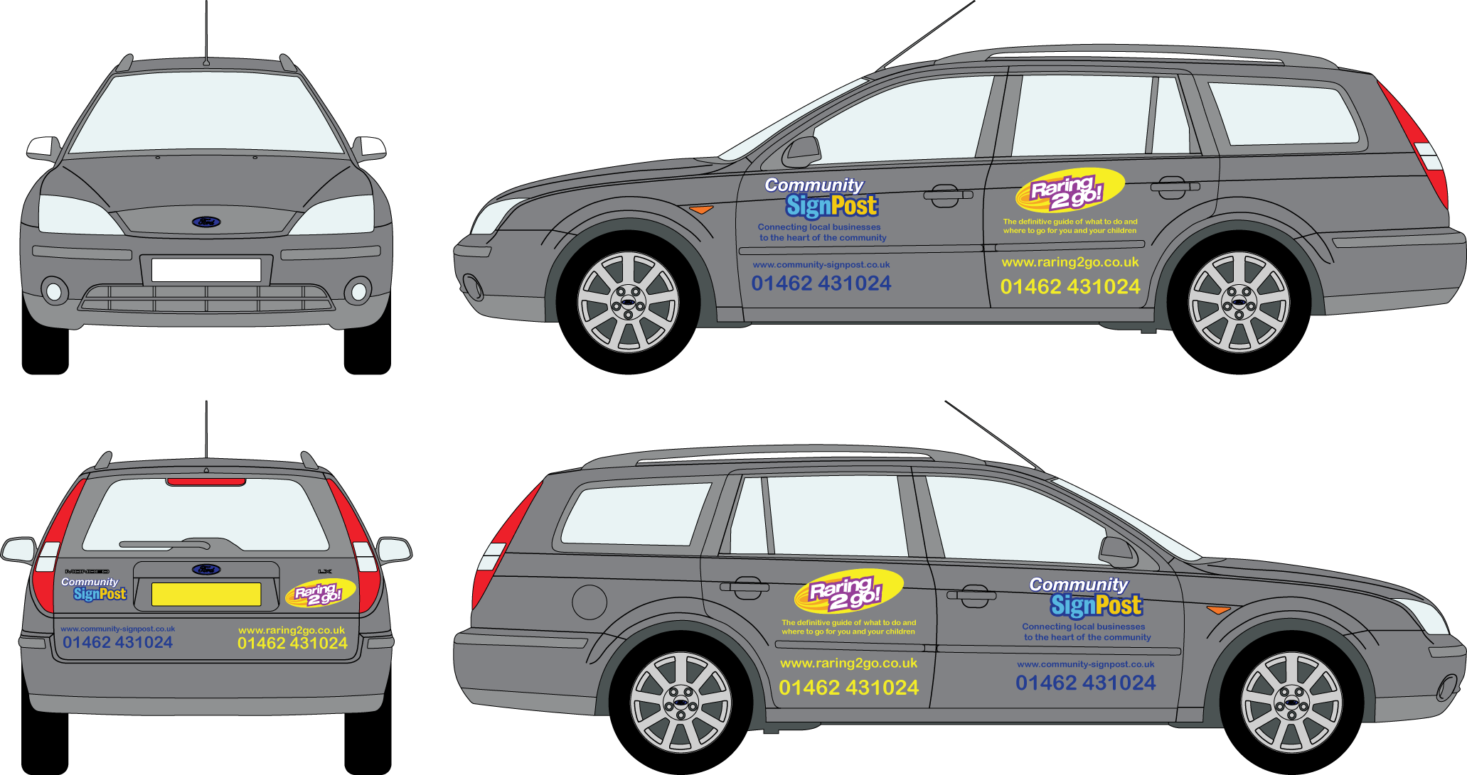

    I have to do a layout on a Ford Mondeo estate which should be stright forward as i only have 4 items a logo, a strapline, a web address and a phone number.
    The trouble is that these people have two business and so i have 2 of everthing, also the straplines they want on there are quite long.
    Has anyone done this before, would you do one side of the car one company or idealy each company on both sides with one on front door one on the rear door or as an estate one on the rear window.
    Any ideas would be grand.
    Best regards
    Russell.

    4 February 2009 at 09:42
    hard to think about it without seeing what they are looking for but i would probably keep one door for each company.
    i would try and keep it as simple a design as possible keeping to the same format and area covered, clearly distinguishing its an ad for two firms.
    LOGO
    COMPANY NAME
    STRAP-LINE
    NUMBER
    WEB
  • Russell Huffer
    4 February 2009 at 09:49
    The only problem is the straplines,
    Connecting local businesses to the heart of the community.
    and
    The definitive guide of what to do and where to go for you and your children.
    These are just so long, one thought i had is to wrap them around the logos but what ever i do they are not going to be easy reading at 70 mph.
    Regards
    Russell.

    4 February 2009 at 10:32
    quick mock-up…
    this is sorta what i was trying to explain…
    although im only showing one, both layouts to be self contained on each door.
    i think if you tried to oversize both adverts, from a distance, they will merge and just look too much, untidy etc
    anyway… you may have other plans and you may have a difficult customer to convince… the following draft is just various sized lines of text, info, logo etc laid out along the lines of what i meant.

    4 February 2009 at 11:04
    we do allot of taxi adverts on the doors similar to this. often across two doors too but in similar format. most of the time the mondeos have colour coded bump strips, so are gloss/smooth and can be applied right over. [best checking though]
    if your info runs over the strip, simply increase the space between two lines of text so that it falls above and below the band but keeps the panel [if using a panel like the KFC one above] running over it and again, keeping the advert area self contained, so to speak.
    the space i would create in this instance would be between the finger licking good and the phone number as it keeps the company branding above the moulding and the contact info below it.
    hope this makes sense 😀

  • Russell Huffer
    4 February 2009 at 17:54
    Been doing this between jobs today, have done both companys on the back with no strapline and given a door each on the side.
    Not sure i like it but need to have a rethink and come back to it now.
    Thanks for help.
    Regards
    Russell.

    5 February 2009 at 01:40
    Hi russell the following is just another quick mock-up of what i am trying to say by instead of trying to design two companies artwork to suit a car. have two self contained adverts simply sized to suit.
    just taken your own artwork here from the top design and resized and introduced a panel with my layout in the bottom picture.
    the panels defines its two adverts at a glance. but almost in exact same format/layout as each other. the panels also help create a balance because without them the various lines of the vehicle start throwing lines of text off here and there.
    as i said, you may have a difficult customer that just wants it all stretched to hell and looks knickers… but thought ide try explain anyway.
  • Gavin MacMillan
    5 February 2009 at 11:06
    I like what Rob has done, probably the best you will get this to look. You could try and extend the panel of the top and bottom to see how it looks but your customer should be happy with this.
  • Russell Huffer
    5 February 2009 at 12:36
    I like Rob’s idea as well only problem is I have just been to look at the car and the bump strip across the middle of the door is soft rubber, so would not be happy laying vinyl over it.
    Regards
    Russell.
  • Russell Huffer
    5 February 2009 at 14:45
    I have sent this off to the customer to get there opinion.
    Thanks for all help and input.
