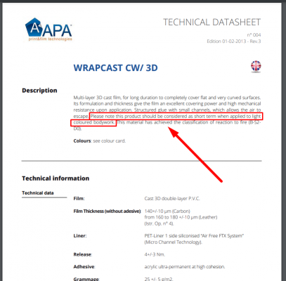

    We wrapped a bonnet in a carbon fibre cast material (APA CW/CWR 3D), then applied a decal on top of it.
    It has since started to fail. We subsequently were advised that due to the coating on this wrap material it is not suitable for applying graphics over the top of it.
    Is this the general rule for all cast warp material, or perhaps just for this particular type of cast 3D carbon fibre material?

    I guess it depends on what their top coat is if it is a multilayer material.
    I haven’t had a proper read, but their product info guidelines should cover what they claim.
    A new one on me, and it may just be the way they are describing it, that does not make sense. but why does the colour of the vehicle shorten the life of the film from a 4-6 year cast to “short term” and how short is short term? 🤔
