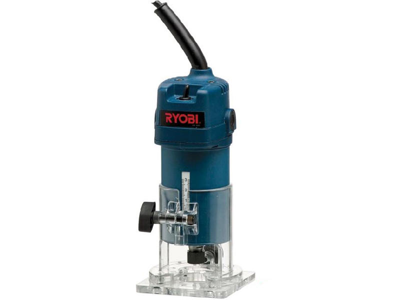

    if its only foam you might be better off using a small laminate trimmer with a 45 degree blade and just take the tip off with a grinder, works perfect with a straight edge but does create a mess
