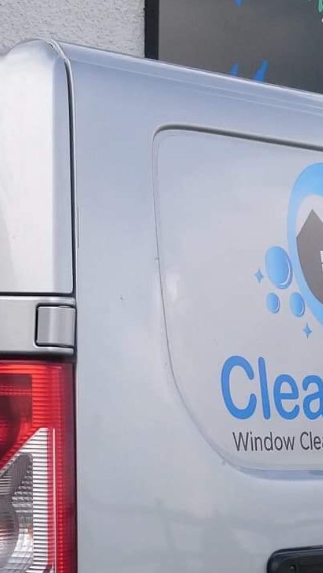

    Wish I had a photo of the van we had in recently. Had been inlay panels and am guessing when it was removed the lacquer and paint had gone with it. Had been touched in with a light re-spray and was a old banger anyway, but my god. Corners weren’t even first go. There was 3 or 4 cut lines on each one all following slightly different curves.
  • Kevin Mahoney
    July 3, 2019 at 9:18 pm
    Seen a few like that, client recently bought an old snotter as a pool van. It was wrapped in a previous life & I think it was trimmed with an axe. Cut around the number plate was horrifying, somebody get that man a screwdriver
  • Chris Wilson
    July 3, 2019 at 9:25 pm
    Here’s the bad boy. I’ve zoomed in but even from afar you can see the difference in the paints and thickness.
    But yes +1 for knifeless tape.
