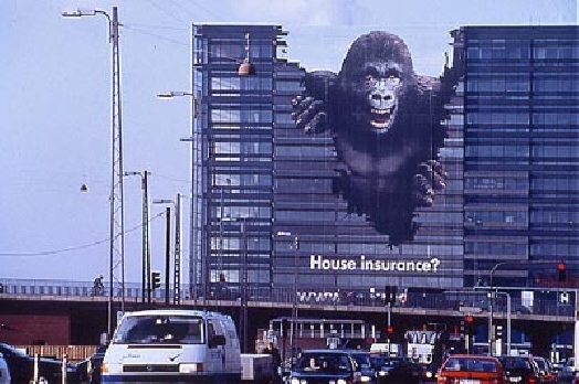

    Hi Carrie, these huge building ones , I assume its mesh banner and they’re made in sections and stitched together, I ask this because I was looking at some the other day and cannot see the join, anyone explain how its done? as I’d like a go at doing these.

    hi outline
    the building one looks like a building wrap…
    this is basicaly digital printed vinyl stuck to the glass of the building. doesnt really work unless the part being covered is all glass face.
    normal the vinyl used is something like controvision. this way the people in side can see out as normal but from the outside you see this huge image. its not always controvision but most of the time its a sign/ad like this.
    the banner one you are talking about is normaly for building with scaffolding up for long periods of time. basicaly the digital print is printed onto banner “mesh” (perforated banner material) you can print directly onto this with your cadet.
    the idea behind it is it hides the horrible scafold structure.
    at the same time the people owning the building make money from the advertiser, the printer makes money from the sale & im sure the scaffold people will get a cut from it in some form. you need to use the perforated
    banner matrial to allow the window to pass throug it.. other wise in bad weather the whole thing could act like a sail and pull it down.

    Yep I was going to say what Rob said *cough* ummmm ok perhaps I was not 😛
    Outline I actually thought it was a banner on the building aswell and was wondering how they would fix/fit it safely and how you would go about making something like it? But as Rob said its probably contravision or the like ……… great job though … or at least I think so ….. a lot of work involved!!

    17 October 2004 at 20:45
    that king kong building is bloody good……..eh!! 😛 😛
    top marks to the person who thought that one up!! 😀
    would not like to be the person fitting them though 😮 seen a demo of it in an avery magazine a while back!! scary!! 😀
