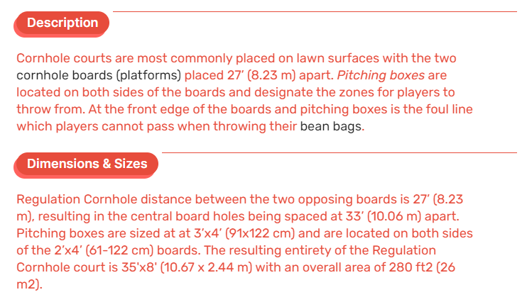

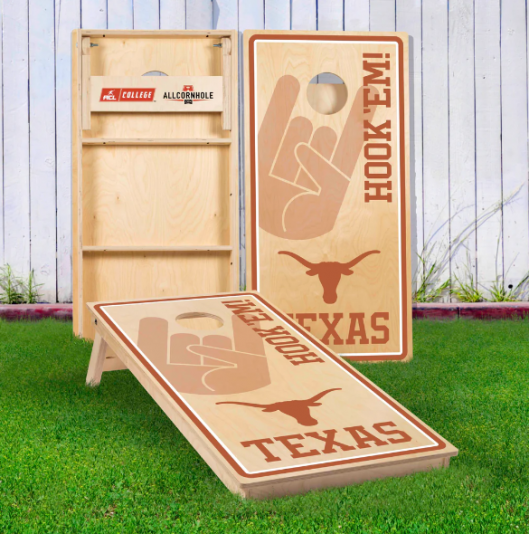

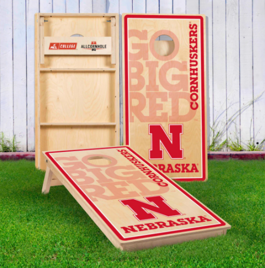

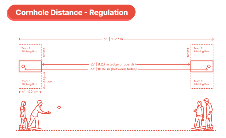

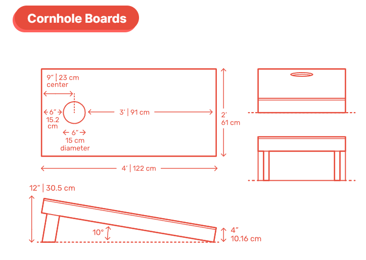

    Hi Harry
    I have attached some images and info that popped up on cornhole boards along with the dimensions, which were pretty straightforward, so I quickly created a pdf to size. I have attached them all and some…

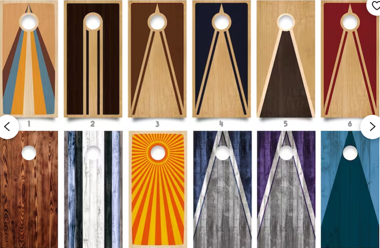

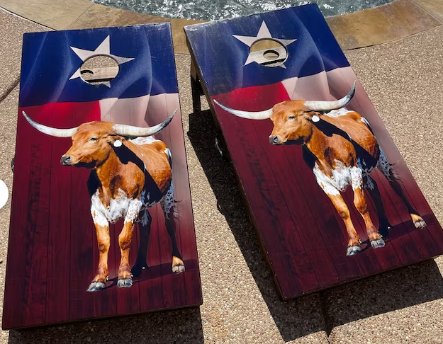

    January 2, 2024 at 6:39 pm
    As you can see from just a few designs for corn boards that I have attached. there doesn’t appear to be a fixed design layout as such. looks like pretty much anything goes!
    I have attached a PDF Vector template for the corn boards:
