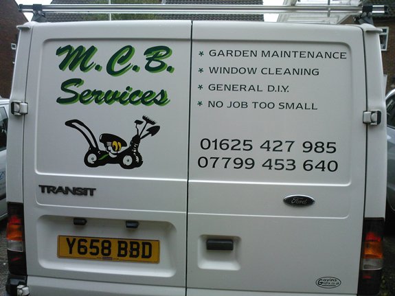

    a recent van

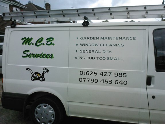

    another van

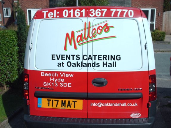

    another view
  • Gavin Conway
    28 November 2010 at 01:04
    Foxi… phone number not my cup of tea but it does balance with front door.. ?

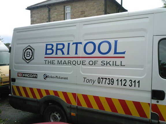

    Local Britool dealer

    Hi Gavin, I think that overall these van layouts are OK, I like the Britool van the most.
    You need to pay attention to your sub/secondary copy ie. telephone numbers service descriptions on the Malteos and Foxi jobs. They need to be reduced in size to fit the panels. ‘Also inside Megasun etc. lets the job down, if it was smaller and centred on the bottom of the doors it could have improved the overall look hugely. Try using a slightly different font than Helvetica, just doesn’t look good to me.
    The rear of the MCB Transit could’ve been tightened a little with the copy not being so close to the top and bottom of the panel.
    I think you almost cracked with the Britool van though, this looks great. I would just alter the tel’ number.
    Keep up the good work Gavin, as you say, just as good if not better than many layouts seen here.
  • Gavin Conway
    29 November 2010 at 09:35
    Hi Neil… thanks for the comments… Britool was entirely my handywork.. Foxy was a bit of both but the customer was adamant on the layout.. Matteos was so persistent with his design – it was a shambles originally. I tried to get it better than it ended up.. I see about the transit being to close to top and bottom..
    I’ll get the book asap.. Cheers
