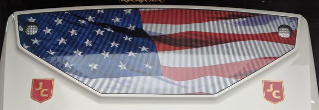

    I prefer 3mm / 2mm rather than 2mm / 2mm. the 3mm giving a bit more strength to the image or obscurity over the spaces. from the inside, there is very little difference, but from the outside, the image is stronger or in your case the limitation of seeing inside.
    this rear bus window is based on 3mm / 2mm.

      You can do these yourself. Just print on grey backed material, and set up a cutter for the stripes. If laminating, it’s best to use optically clear. I think Rob may have done a tutorial a few years back, but I could be wrong.
