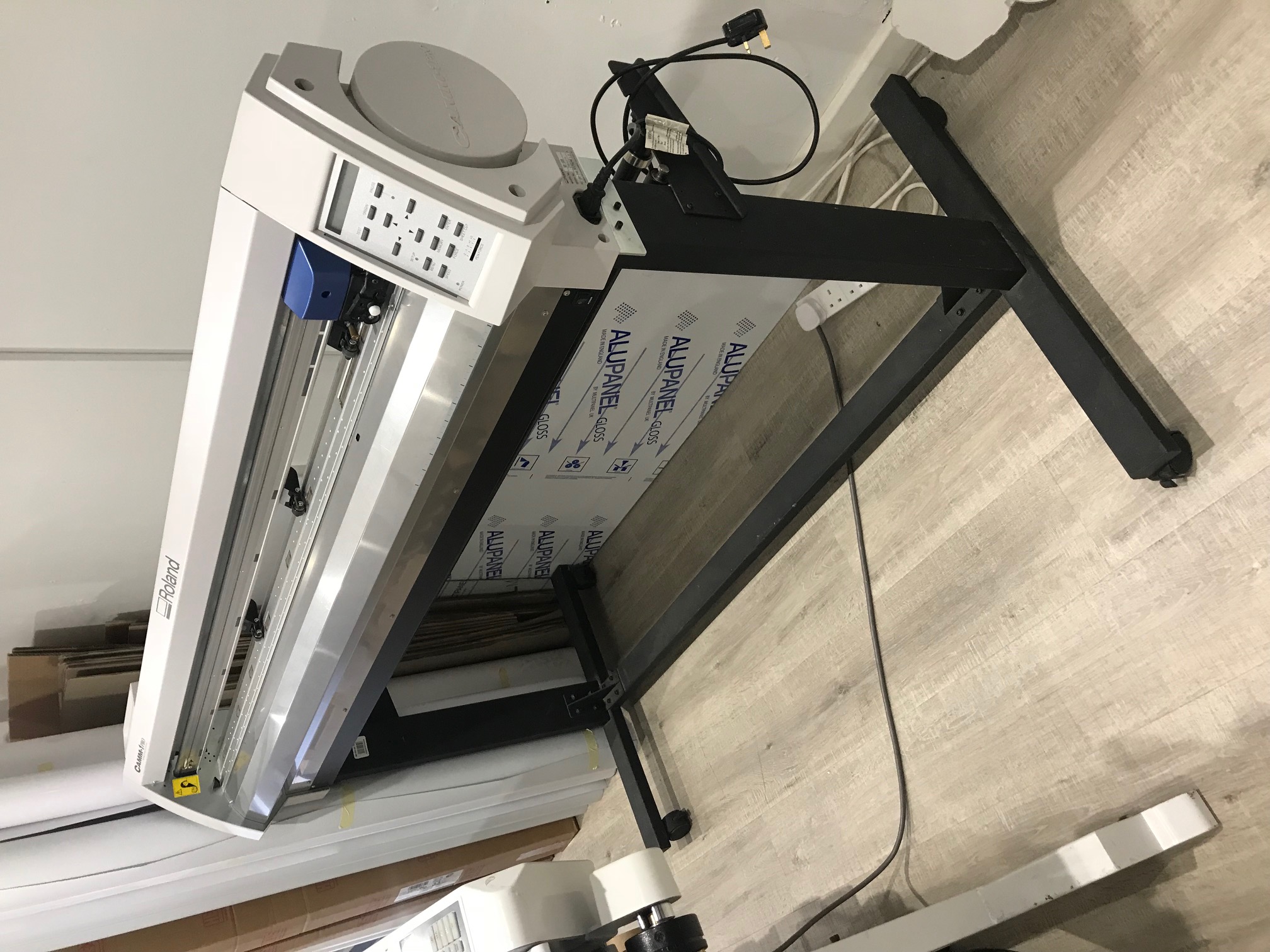

    hi Mathew, we are looking at putting our 54inch gx540 up for sale if your interested? its £1600. we used to run a print/cut roland then changed over to a ej640 with seperate cutter and have never looked back, we do alot of print cut with lamination so used to always have to wait for print jobs to finish before cutting them all, now by the time the next print job has finished we have weeding and packed the previous jobs, its halved our time for jobs,

    Certainly interested although i’ve tried looking up the model and can’t find any information. Im just either getting gx500 50" or gx640 obviously 64inch. I would say if you could message me with some more details that would be great but not sure if I can access that unless I become a full member?

    Hi Matthew sorry i ment the gx500, i have the gx640 as well as we own a 64in ej640, i kept both thinking i could cut on both or use one a stand alone cutter and the other as a print cut but majority of my work is print cut so we seldom use the gx500 now, i literally took pics the other day to put up for sale on that well known auction site lol, not sure if id need to put up in equipment section buy/sell (rob if you could let me know if ok tia) its only ever spent its life in a clean office and not been work hard as when it was only cutter we had the print/cut machine.

    Looks in great condition, where are you based Shawn? Were in Stoke-on-Trent
