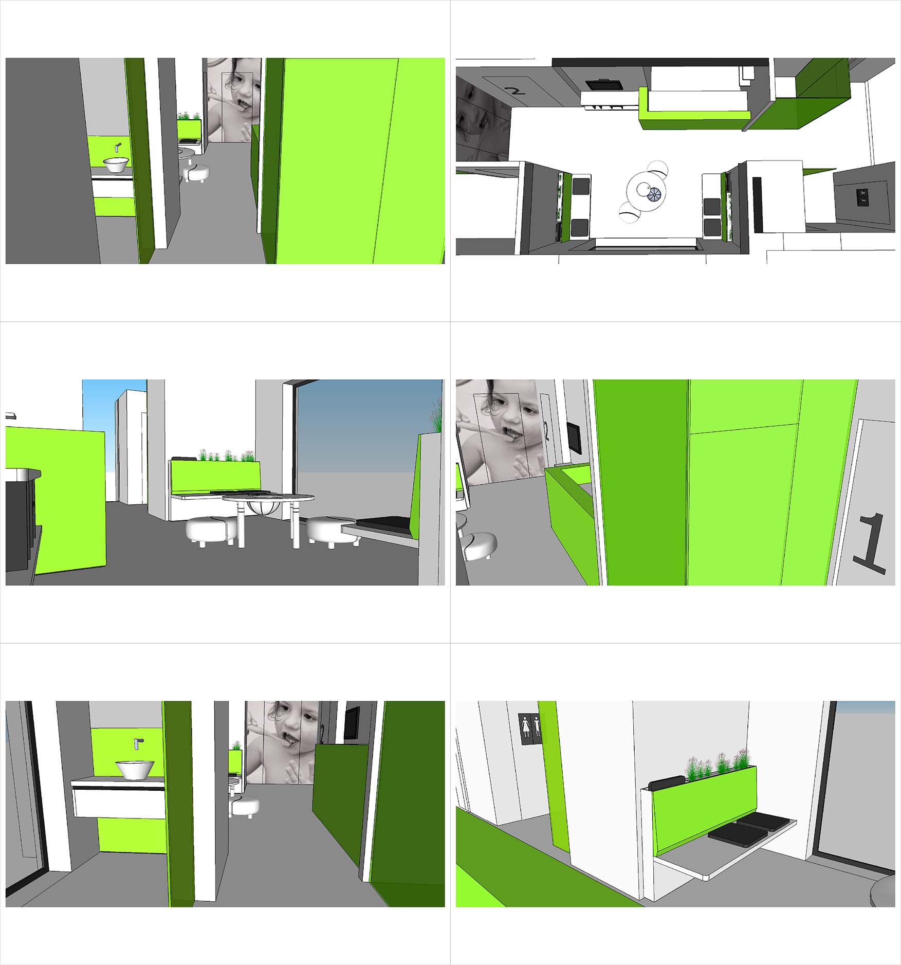

    I have been contacted by an Interior agency, the wanted me to do complete interior for a dentist. Lot’s of glass panels that the wanted to be covered by a lemon green vinyl, but this vinyl may not block out light, and might also not been a see tru vinyl.
    I was thinking about applying first a etch vinyl on the glass surface, who doesn’t look milky or metallic and then apply the coloured transparant vinyl onto it.
    Does anyone knows vinyls that do not block out light, but are coloured, and if so a lemon green colour in their range 🙂
