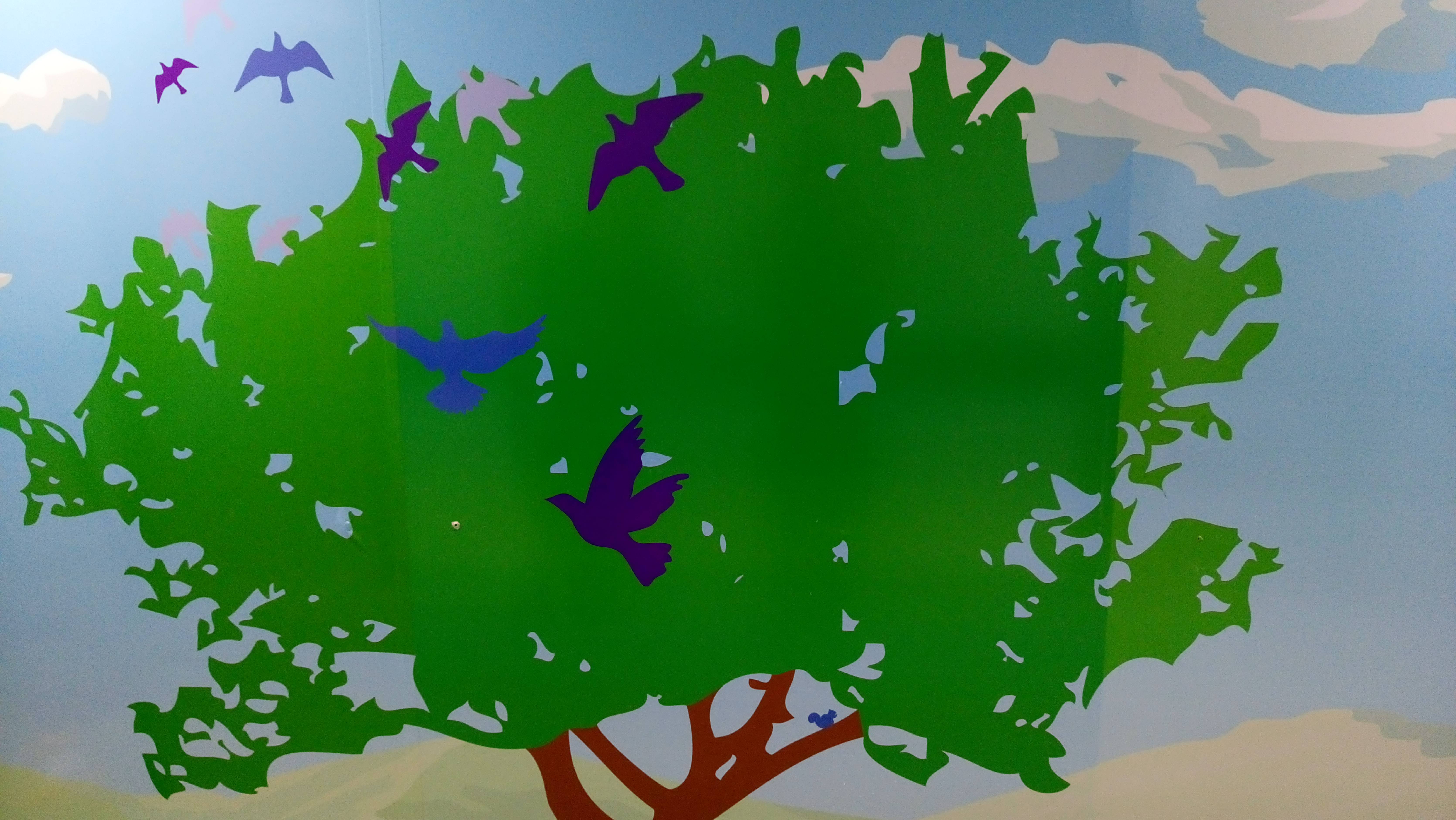

    We’ve been having problems with colour shift on our prints. The print went through on the same run and was place alternated as recommended in the Roland academy course. Each section is around 2.4m x 1.25m. As you can see each section has different colours and the one on the left is also darker on the lower part of the print than the top.
    I would welcome any suggestions on how to resolve this problem.

    Did you apply the same profile in versaworks, and same colour management option?

    Had the printer/room/vinyl heated up when you started printing?
    Sometimes if you print first thing int he morning, by the time the 2nd/3rd drop is printing the room and vinyl is a different temperature which can effect colour.

    The colour management and profile settings were the same through all prints.
    The prints were started at the end of the day, but all 30 of the panels have different colours.

    What media was it printed on? What profile?
    You can always log a ticket with Roland Tech Support too.
