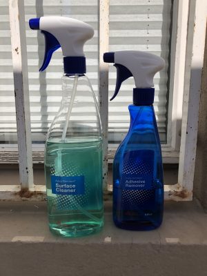

  • Pane Talev
    October 1, 2021 at 10:00 am
    Green, to clean before applying vinyl.
    Blue, to remove glue.
