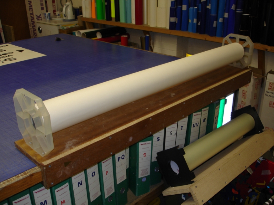

  • Peter Shaw
    February 1, 2007 at 6:55 pm
    – Completely portable
    – Slides onto the end of the workbench
    – Made from 3 bits of chipboard, 2 roll end plastic thingies held with 4 screws
    I’ll take a couple more pictures tomorrow and post them.
  • Peter Shaw
    February 3, 2007 at 10:37 am
    App Tape Dispenser 1
    Roll end support simply screwed to a length of chipboard

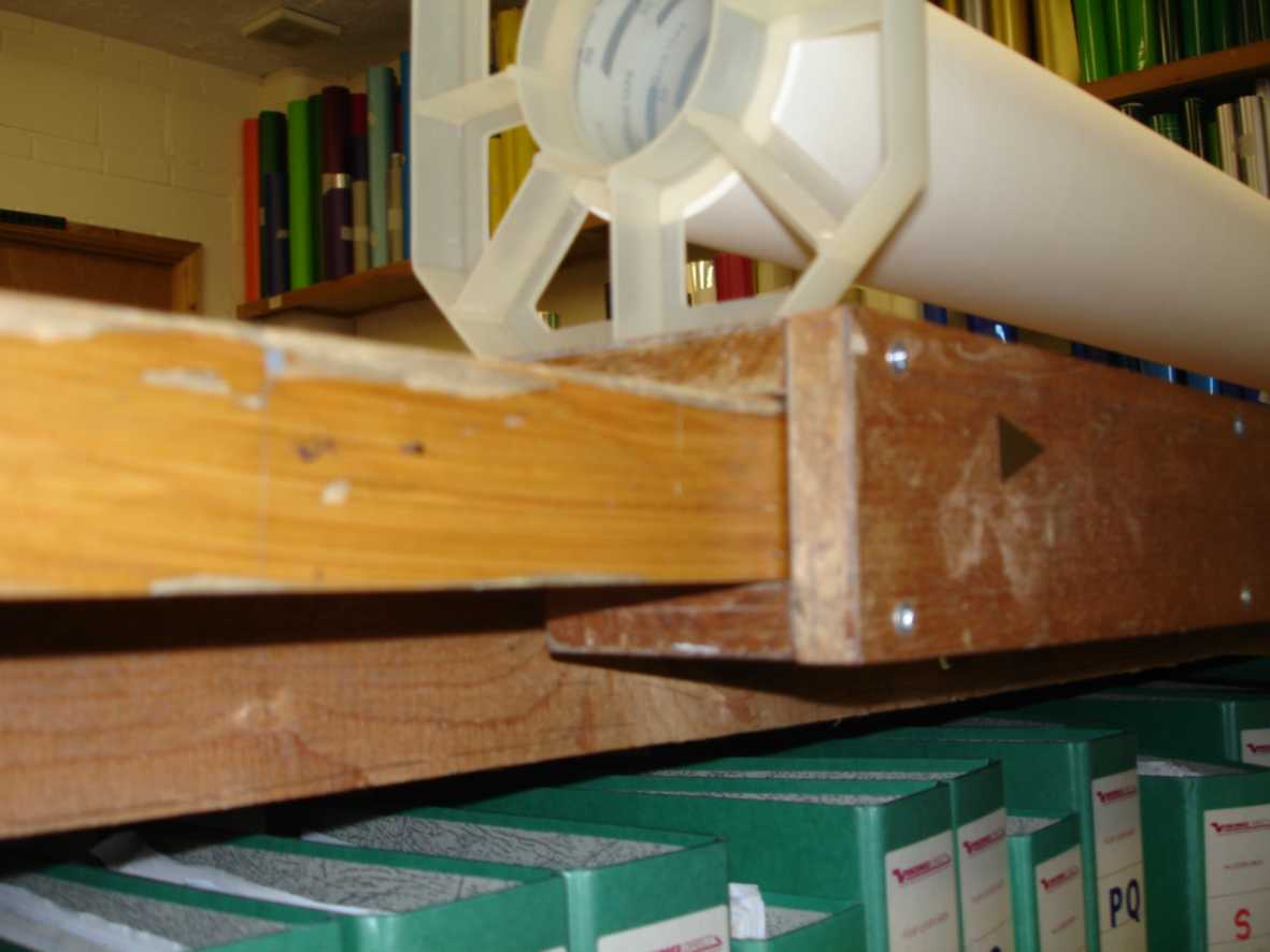

  • Peter Shaw
    February 3, 2007 at 10:40 am
    App Tape Dispenser 2
    2 other lengths of chipboard are screwed on to fit the width of you bench end

    Peter that must be the upmarket version, when I made mine I just used a couple of cheap quick release clamps to hold it on the bench !!!!

    Wow Peter, that’s brilliant.
    Thanks for posting.
    The black end cap one must be the Deluxe version 😀
