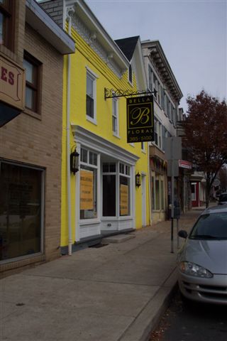

    Routed Carved Clean Out HDU. sign is 3′ x 5′
    had the bracket custom made.
    painted with automotive base clear – satin

    November 27, 2005 at 10:30 pm
    that is nice Steve I imagine it’s a florists.

    November 27, 2005 at 11:16 pm
    nice sign steve…simple but effective 😀
    i dont know if its the photo…but i would have made florists line up with the box..and brought the whole thing in just a bit, and moved the tel. no up a bit too….sorry i have to say what i see 😀

    November 27, 2005 at 11:26 pm
    Thanks Nic… i think some of that was the pic, but good points.
    the word Floral is lined up with and the exact same width as the box. To me it looks off to the left, because of the L on the end.. Same with Bella, although i do have that slightly off center to the right.

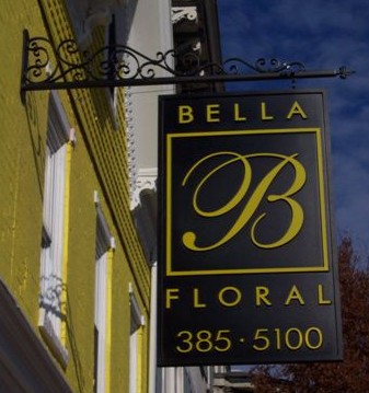

    here’s another close up…
    I still make everything too big.. even after i scale it down some.

    November 27, 2005 at 11:44 pm
    brilliant work mate, very smart…
    i was gonna say that brackets holding a hell of a weight but hdu is very light. so that bumped that thought on the head. whats the frame of sign around edges made of steel?
    i like the sensible use of cable for extra support. i tend to go this route with signs projecting as far out as this.
    do you carve the foam yourself or buy it in done?

    November 27, 2005 at 11:46 pm
    Nice one Steve. I really like the bracket and the cables are a good idea.

  • steve geary
    November 28, 2005 at 1:40 am
    quote Robert Lambie:
    It’s all Foam Robert. routed 3/8′ deep. just a 1′ border on the edges and the part with the lettering are all flush .
    Two 1″ pieces of hdu Glued together with two Verticle Aluminum rods, in the middle – Drilled and tapped for the eye bolts.
    quote J_J_O:
    Very nice stylish sign Steve?
    Did you do this by hand or is it CNC routed?
    What is HP vinyl? JJ
    JJ, it’s Cnc routed. wish I had the time and skill to do it by hand.
    HP = high performance… but it’s cast – 8 year vinyl. I used that on this sign instead of paint for a cleaner look.

  • Leigh
    November 28, 2005 at 1:40 pm
    Well you really have been busy Steve!
    All really nice work by the way.
    Where are you getting your custom made brackets from?
  • steve geary
    November 28, 2005 at 2:09 pm
    Leigh…
    this guy just started making sign brackets last year. He’s really good and has quite a few different styles.
    They are a little pricey, but the quality is top notch. It’s a high end product. I highly reccomend them.
