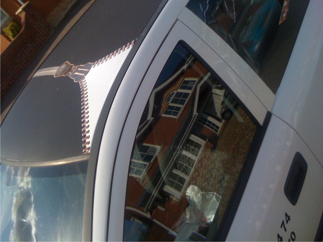

    used spandex with no problems except this one attached. Guy tints windows and helped me but tore it near the front so printed a zip to cover it up

    oh lol Chris…quite a coverup!!
    yeh it was a cold day when the stupid stuff ripped…
  • Chris Windebank
    March 27, 2012 at 4:21 pm
    this was the second time around, I was going to send him on a wrap course but he said he was good!

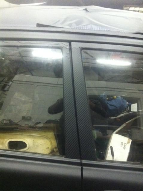

    I know this is an old post, but I have used KPMF air lease carbon, it looks fantastic, very nice straight lines:
